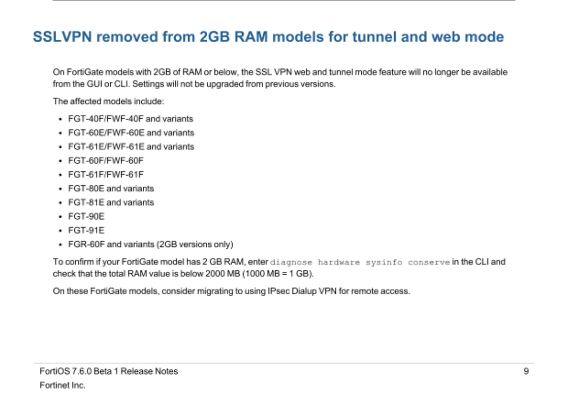

I was just in a fast track course as a fortinet partner and I was told by the host of the event, that the new G series version coming out and also upcoming firmware upgrades (SSL-VPN removal is for 7.6+) will have SSL-VPN removed if the fortigates have 2gb RAM and under.
Be warned.

That would have a devastating impact. At least "=< 60F" would lose the feature. I'm wondering why they can't keep it with smaller models by limiting the max users.

Hello @resler ,
They just didn't remove SSL-VPN with the new version. With 7.4.4, proxy-based features (ZTNA, Server Load Balance, Proxy Based Policy etc.) will no longer be available on models using 2GB RAM.
https://docs.fortinet.com/document/fortigate/7.4.4/administration-guide/519079/proxy-related-features-not-supported-on-fortigate-2-gb-ram-models-new
