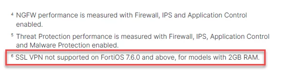

I'm looking to propose a FortiGate ruggedize 60F for an industrial environment, after reviewing the datasheet I notice that SSL VPN might not be supported.
Extract from the Datasheet
There is nothing in the data sheet which indicates the memory of the device, for this deployment SSL VPN will be required. Can anyone provide some clarity on this?

You can use the command below to check the memory :
diagnose hardware sysinfo conserve
Further information regarding the features no longer supported for the devices with 2 GB RAM please check the Fortinet documentation >> https://docs.fortinet.com/document/fortigate/7.6.0/fortios-release-notes/877104/ssl-vpn-removed-from-2gb-ram-models-for-tunnel-and-web-mode

alternatively you can use below command to see the total memory size with other hardware info.
FortiGate-60F # get hardware status
Model name: FortiGate-60F
ASIC version: SOC4
CPU: ARMv8
Number of CPUs: 8
RAM: 1917 MB
EMMC: 3662 MB(MLC) /dev/mmcblk0
Hard disk: not available
USB Flash: not available
Network Card chipset: FortiASIC NP6XLITE Adapter (rev.)
