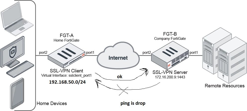

kindly as Example in the link bolw i try to connect Fortigate to fortigate (site to site ) via ssl-vpn
(isp is blocking the ipsec)
the issue is i can't reach the forti ssl vpn client subnet as picture below
https://docs.fortinet.com/document/fortigate/7.0.0/new-features/508779/fortigate-as-ssl-vpn-client

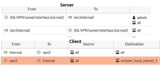

"check failed on policy 0, drop"" basically means that there is no matching Security rule for this traffic. The example you use mentions creating policy in one direction only - from VPN SSL client to the other side. For bidirectional traffic you will need to create a mirrored security policy as well, with (as per example):
Incoming Interface: sslclient_port1
Outgoing interface: port2
hassan4mz
hassan4mzAuthor
August 8, 2022
I did already in policy in and out but still same issue i think the problems in ssl-vpn interface (client ) not reverse the route
