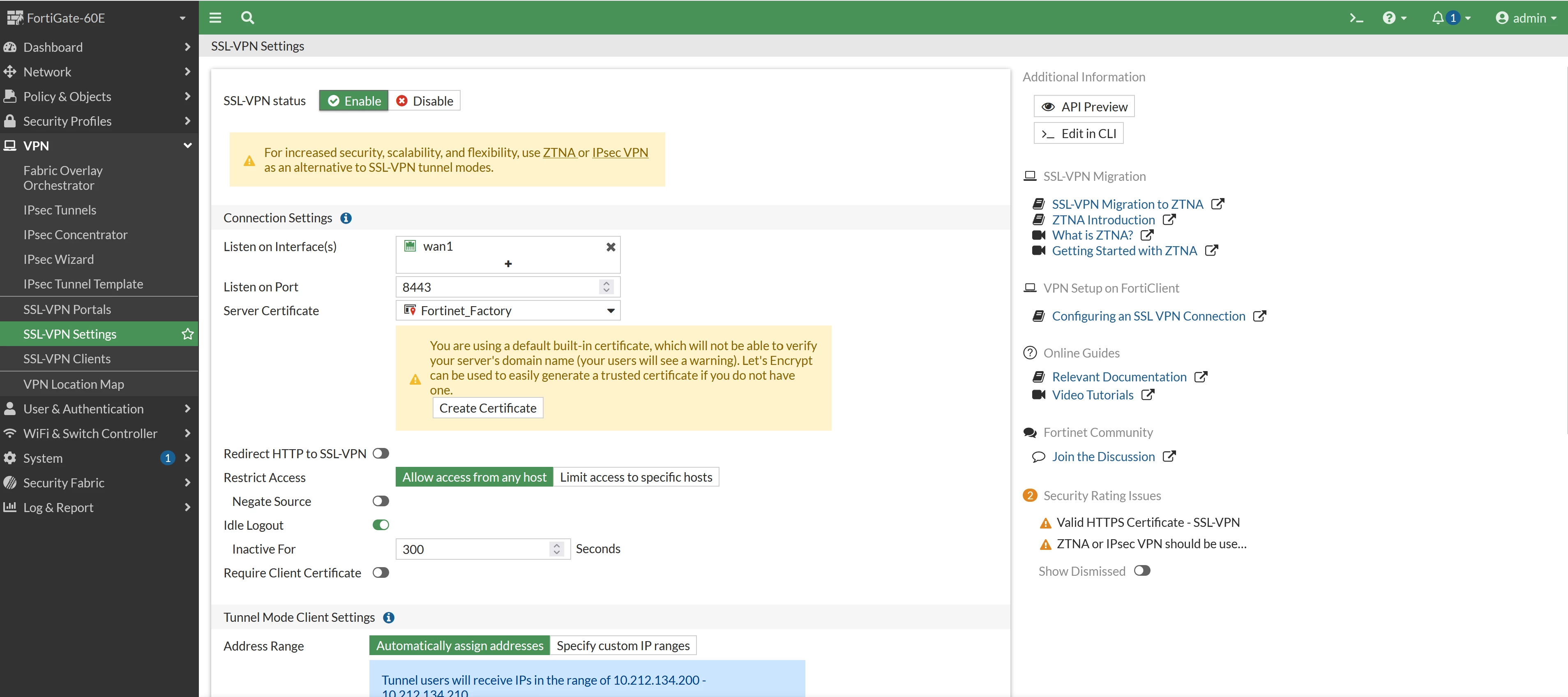

SSL VPN full-tunnel client not getting Fortigate's WAN IP

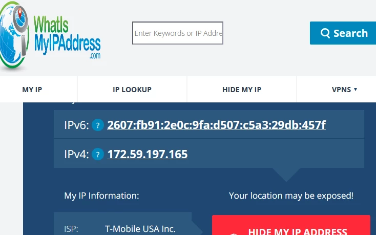

I’m trying to set up a full-tunnel SSL VPN on my Fortigate 60E running 7.4.6 and for what ever reason, when connected to Forticlient if I go to a website that shows your public IP (ie- www.whatismyipaddress.com), it is showing my laptop’s local internet connection’s public IP instead of the fortigate’s WAN IP. I have tried using the ‘full-tunnel’ portal, disabling the ‘tunnel-access’ portal, changing both to ‘full tunnel’ in the SSL VPN settings and disabling both and creating a new portal which is full tunnel, but whatever I do it keeps showing up with my laptop’s local internet connection. I did some packet traces and it *seems* to be egressing the Fortigate’s WAN interface but for whatever reason it keeps showing my laptop’s internet’s public IP. I can ping devices inside the network (behind the fortigate) just fine, so I know the VPN is working. It’s a real head-scratcher. Can anyone take a look at the config (attached to this post) and tell me what is going on?
Of note, I did try disabling IPv6 tunneling and IPv6 split tunneling on the portals in the CLI in case it was trying to use IPv6 for whatever reason, but when I did, neither of them would ‘take’. Not sure if that has anything to do with it.
My connection goes: Laptop (running forticlient SSL VPN) → cellular wifi hotspot → home internet modem → fortigate (and at this point it should exit back out the home internet connection and I should be seeing a public IP when I go to www.whatismyipaddress.com)

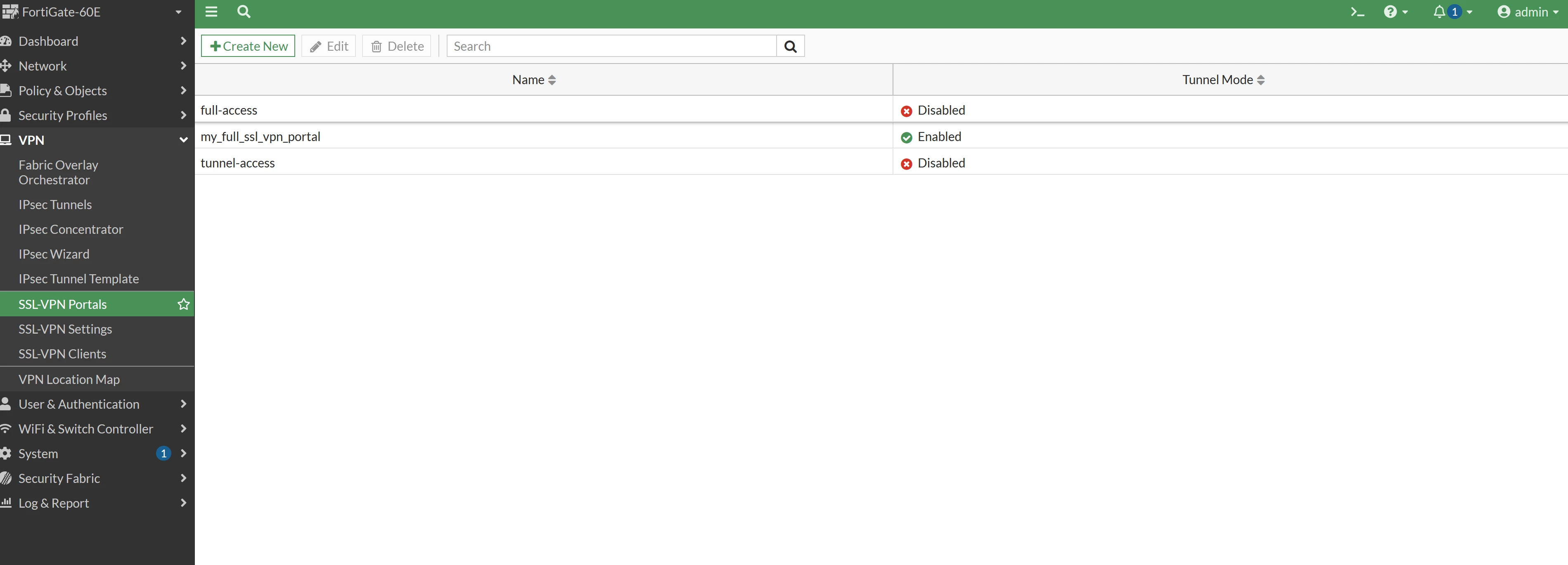

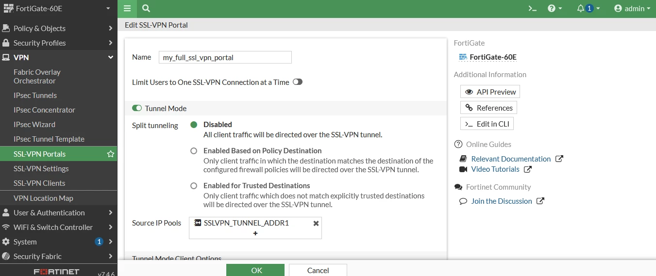

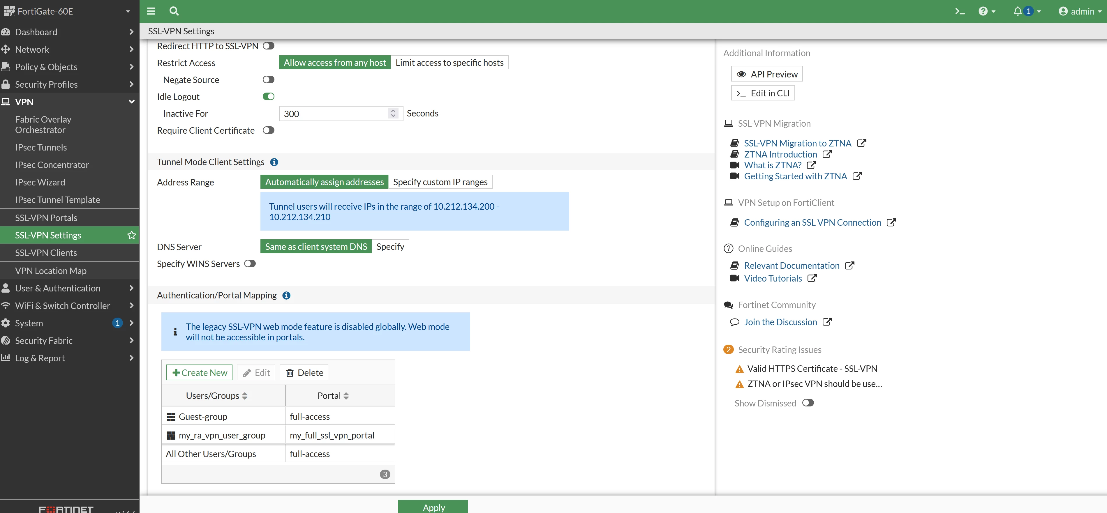

can you share the snapshot of the ssl vpn portal
Thanks, Salon
xen0blueAuthor
September 11, 2026
Sure, see below
sjoshi
September 11, 2026
which is your user group
Guest group or my_ra_vpn_user group?
Thanks, Salon
xen0blueAuthor
September 11, 2026
it is my_ra_vpn_user_group
sjoshi
September 11, 2026

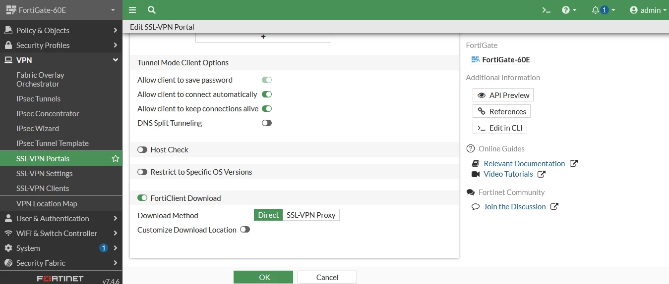

Can you share the snapshot by going inside the my_full_ssl_vpn portal. I would like to check this portal config
Thanks, Salon
xen0blueAuthor
September 11, 2026
Sure, see below:

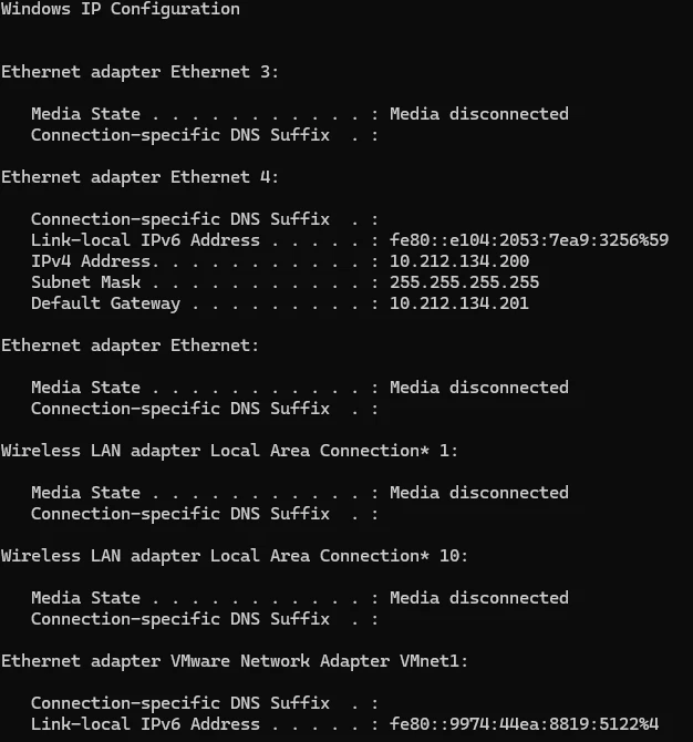

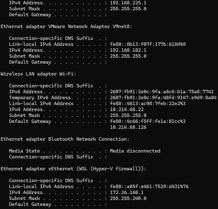

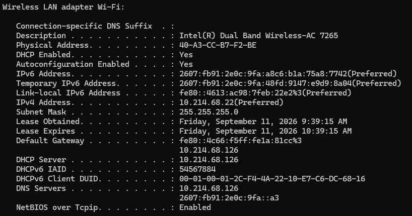

Yes, I am connecting using myvpnuser and this is the output of that ‘route print -4 | findstr 10.212.134’ command:
Also, here is my ipconfig output:

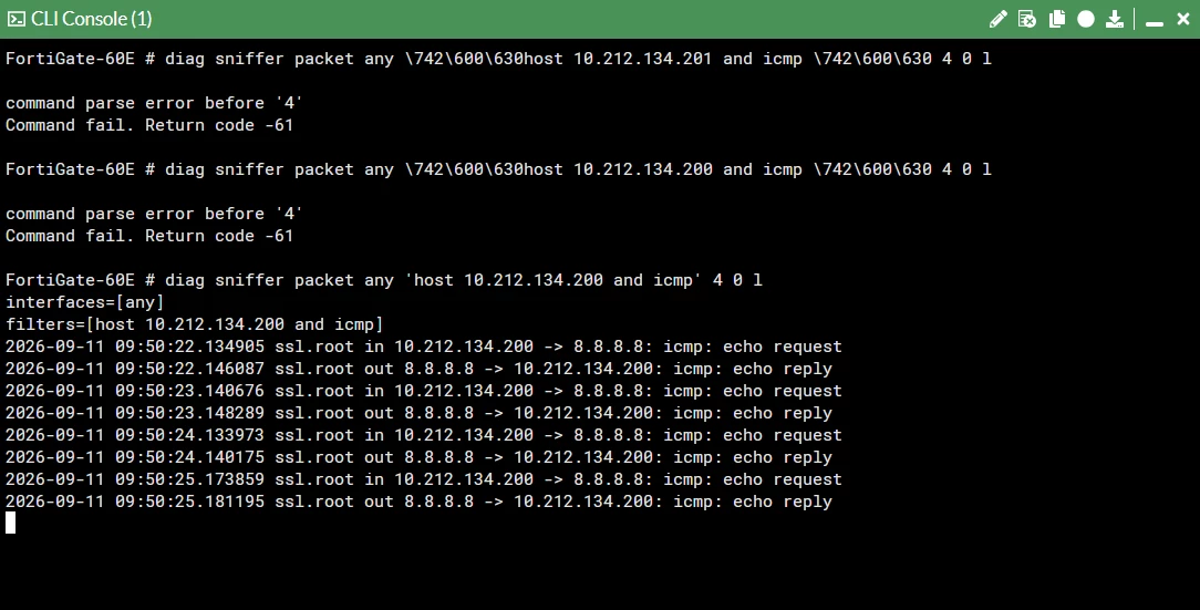

if you do a, diag sniffer packet any ‘host 10.212.134.200 and icmp ‘ 4 0 l , assuming .200 is the IP assigned to FortiClient and then try to do a ping towards 8.8.8.8 , can you see traffic coming from ssl.root and is destined outbound towards the destination using wan1 or wan2 ?
xen0blueAuthor
September 11, 2026
I don’t know if you saw the post above the last, but I edited it to add the IP config info
As far as the ‘diag sniffer packet’ command, here is the output:
funkylicious
September 11, 2026
ok, so basically this would mean that you can ping 8.8.8.8 and traffic reaches the FortiGate on a public destination that you are trying to access.

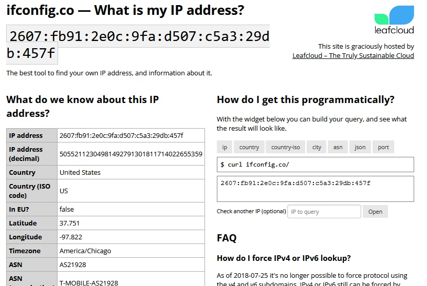

so, if you access a site like ifconfig.co , it will display your home IP and not the FGT IP, right ? if so, that’s quite strange.
xen0blueAuthor
September 11, 2026
Yes, exactly. Correct. It’s being seen from my T-mobile hotspot IP and not my AT&T home internet IP

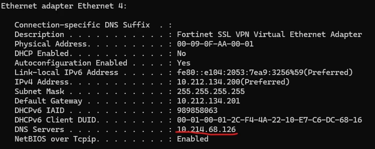

at a ipconfig /all , under Ethernet adapter  Ethernet 4 i assume that you can see as being set for FortiClient adapter/interface 96.45.45.45 and 96.45.46.46
can you try and manually set them to 1.1.1.1 and 8.8.8.8 , then try and do some nslookup google.com in order to see which DNS server is used to resolve ?
xen0blueAuthor
September 11, 2026
Interestingly, it is using a DNS other than the FortiDNS which is configured (probably T-mobile’s DNS server)  in the Fortigate:

Also, well, this was interesting. When I go to ifconfig.co, it only sees my t-mobile IPv6 address but when I go to whatismyipaddress.com, it sees both my t-mobile ipv4 and ipv6 addresses

So what do you think the problem is? IPv6 is taking over?
