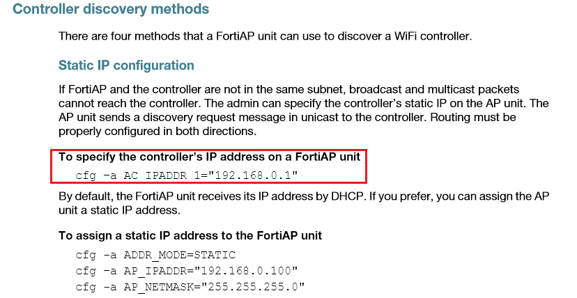

    Hello Dave, thank you for your suggestions. I have now upgraded both devices to the latest firmware, but that didn' t fix the problem. As for the documentation, the 210B should work with the 60D. The AC IPADDR is set - i use static discovery. I don' t know what could be wrong. Here is a screenshot of the config, maybe i' m missing someting. Edit: i have no serial port on my laptop and there is no cable included with the FortiAP, so i am not able to connect to the console.
