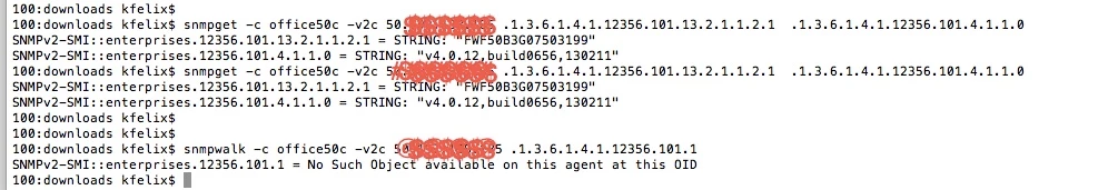

    Does work for me. What are you trying to get? what version of code? What model? Have you ran snmpd debug? diag debug console diag debug app snmp 255 Than walk the tree or get the oid and see if it complains. BTW, I find the following oid is great for model type identification on older devices; e.g snmpget -c mycommunity -O ne -v2c xxx.xxxx.net .1.3.6.1.4.1.12356.1.3.0 .1.3.6.1.4.1.12356.1.3.0 = STRING: " FortiWiFi-60 3.00,build0730,080919" It provides you the model, OS family and build. One I' ve had problems with and snmp deals vdom and snmp issues. So if you have a model running vdoms, you should take that into consideration. And the following is better for newer devices; snmpget -c public -v2c 192.168.1.99 .1.3.6.1.4.1.12356.101.4.1.1.0 .1.3.6.1.4.1.12356.101.13.2.1.1.2.1 YMMV, but I would 1st check the OS and then run debug on the snmpd daemon while walking the tree. You could also just walk the tree and pipe it to grep; and look for the string that your looking for. snmpwalk -c myfgtatofc -v2c 10.10.12.92 .1.3.6.1.4.1.12356 | grep 310 adding a screenshot of my lab200A and I will do a 3040 and FWF60D later.

    I have a FWF40C running FortiOS 4.3.14. When using the iReasoning MIB browser to get .1.3.6.1.4.1.12356.101.1 or .1.3.6.1.4.1.12356.101.1.411, it states there is no such object. Unfortunately, I am not sure what I am supposed to get. Should the query .1.3.6.1.4.1.12356.101.1 against a fgt1000A return a value of 10001? Or, should the query .1.3.6.1.4.1.12356.101.1.10001 against the same fgt1000A return 1? Alas, I do not have access the the models (note- the fgt900F should have been fgt800F) in the original post. The newer device strings work as expected. The older string did not. Thankfully, no VDOMs in place.

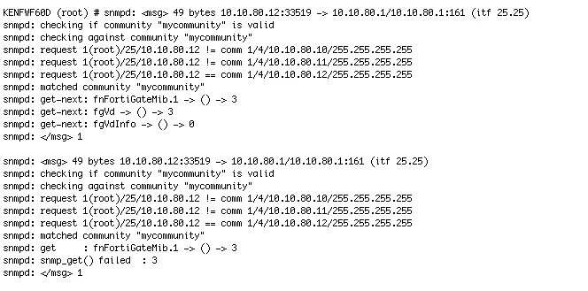

    OP I played around with my 60D which is the only thing I have on 5.0 and debug shows the following when you query that oid You can also debug the SNMP request also, using something like tshark.
