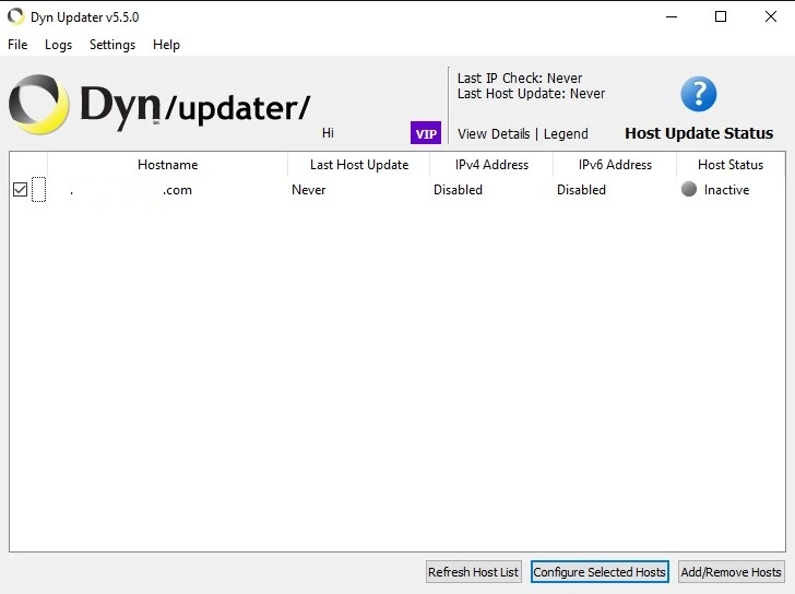

When the FortiGate fails over to 4G modem it is assigned a non-routable IP address 1.XXX.XXX.XXX and for this reason DynDNS service is used to associate 1.XXX.XXX.XXX with a DNS name.

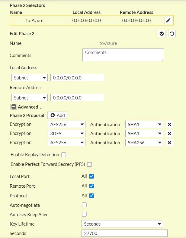

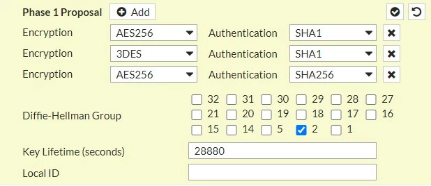

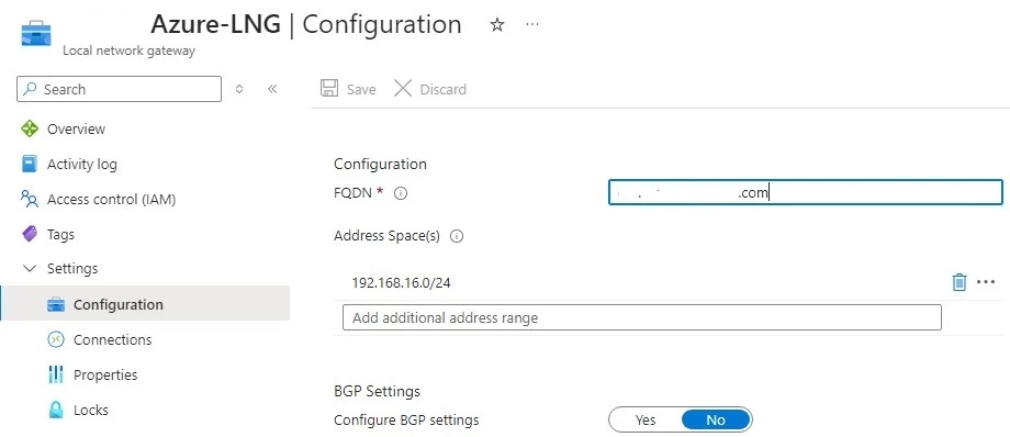

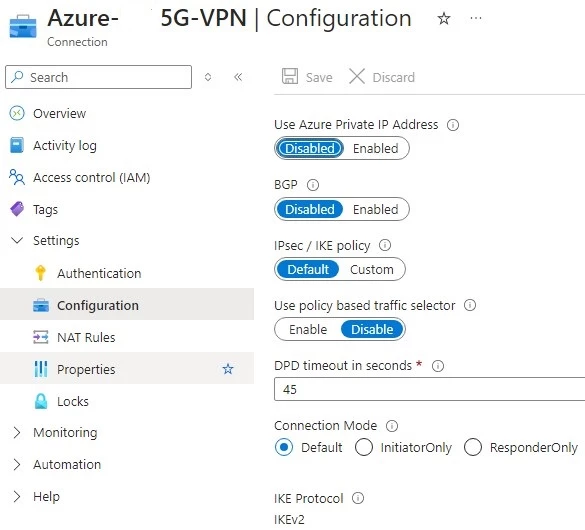

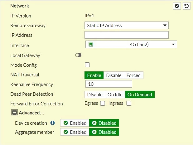

Below are the screenshot of Azure side and on-prem side VPN configuration.
Both Azure and FortiGate configuration for VPN over 4G were copied from working VPN configuration over primary WAN connection.
If someone has experience with Azure Site-to-Site VPN over 4G please advise if something is wrong in my configuration (1st screenshot).
Thanks in advance.

Hello,
First we need to check you have default active route through modem connection.
After that check tunnel is coming up or not, according to your screenshot tunnel configuration look correct.
Make sure you increase priority of modem tunnel route compare to primary tunnel.
