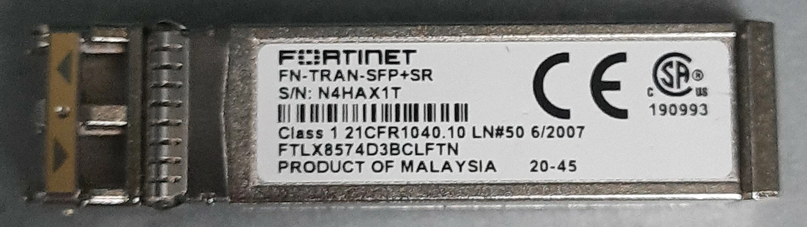

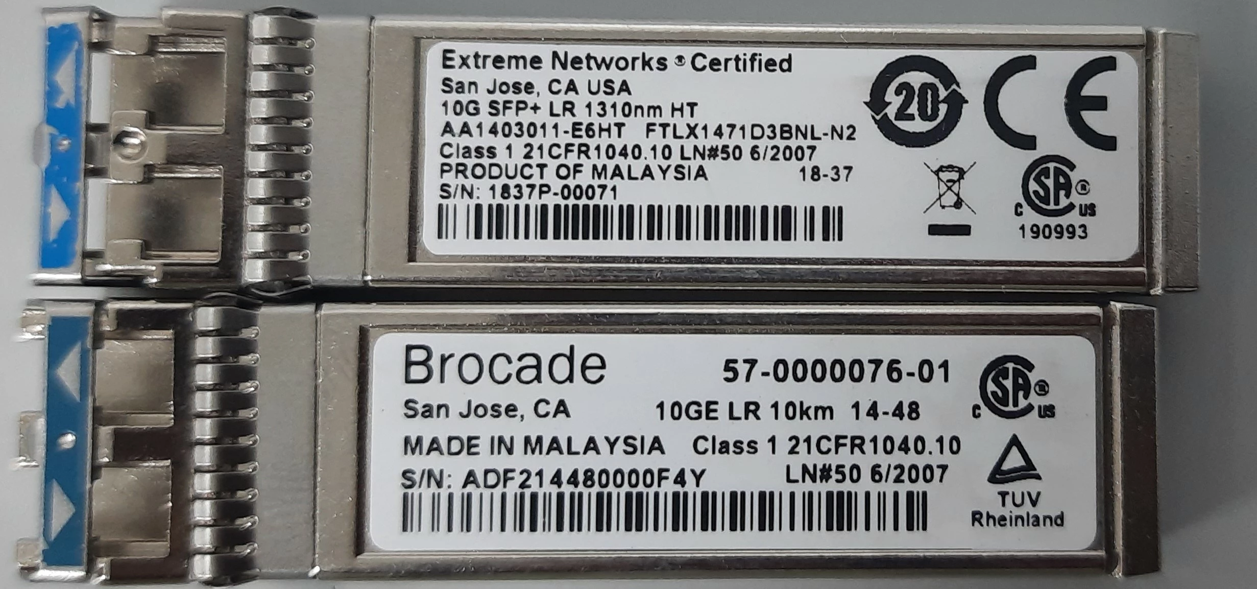

Hi Guys,
I am using Fortigate SFP module on Fortigate firewall & using brocade & extreme SFP module on switch. but the port is not coming up.
Is there any compatibility issue with extreme & brocade SFP module ? Attached are the snapshots.Fortigate SFP ModuleFortigate SFP ModuleExtreme & Brocade SFP ModuleExtreme & Brocade SFP Module
Best answer by Toshi_Esumi
That's because FTNT one is 10G SR and the others are 10G LR. You need to match between them and with the cable type, MM of SM.
Toshi
3 replies
Toshi_Esumi
July 2, 2022
Toshi

Toshi_Esumi
July 4, 2022
Although there is no guarantee with other vendor SFP/SFP+s, FGTs generally don't check vendor code so I would expect those major vendor's ones work on any FGTs.
<edit> Wait. You said you have them on the swtich side, not on the FGT side. Then it's not about FGT's compatibility but switch's compatibility with those vendors instead.</edit>
Toshi

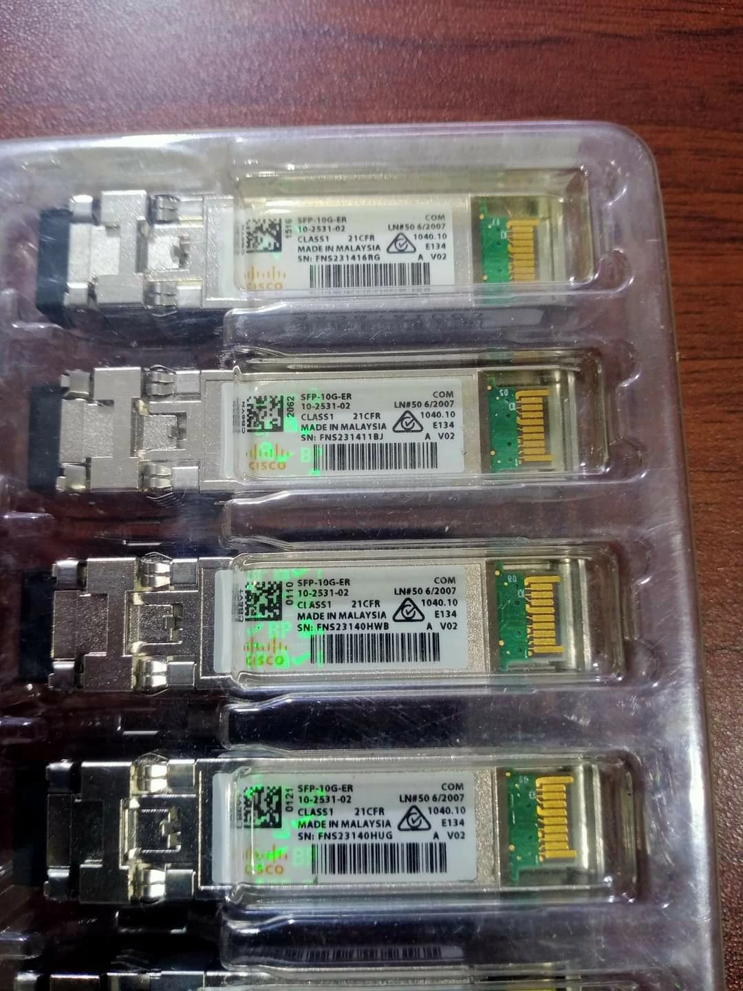

i have fortiswitch FS-148F-FPOE i need to check if i use cisco SFP with part number sfp-10g-er will work with this switch

can you share the snapshot of the SFP module outlining the SKU part no. too
Thanks, Salon
alaa-elbaz
December 6, 2024
