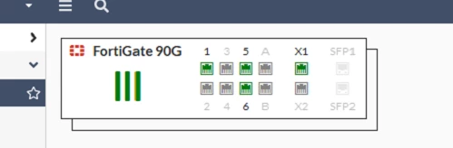

Hello is it possible  to use this feature on FortiGate 90G?
which ports can be used for this purpose?
I try to set port3 and got
command parse error before 'dedicated-to'
Command fail. Return code -61

Hi, @SKIBBIDI  Check below KB for the model support this
https://community.fortinet.com/t5/FortiGate/Technical-Tip-FortiGate-dedicated-mgmt-feature-or-Out-of-band/ta-p/193699
Alternatively, if you looking for OOB, see below KB if your device is in HA setup , HA OOB dedicate management interface works in all HA pari , has no hardware limit
https://community.fortinet.com/t5/FortiGate/Technical-Tip-HA-Reserved-Management-Interface/ta-p/190132
ede_pfau
March 13, 2026
in case of the 90G, I don't see any "mgmt" labeled port in the picture in your last post. So, no OOB mgmt for the 90G.
Don't mix that up with HA mgmt - if you run a cluster you can dedicate one port to management, and it's IP address and gateway will NOT be sync'ed between cluster members. (actually, up to 4 ports...)

from what ive seen its not supported on a 90G - please show me sample config.
funkylicious
March 13, 2026
you have already provided an image of the ports.
there's no mgmt interface and really you dont need one.
you can access the mgmt ports https/http/ssh/snmp on any interface, just enable the services on the port, but not on the wan one.
