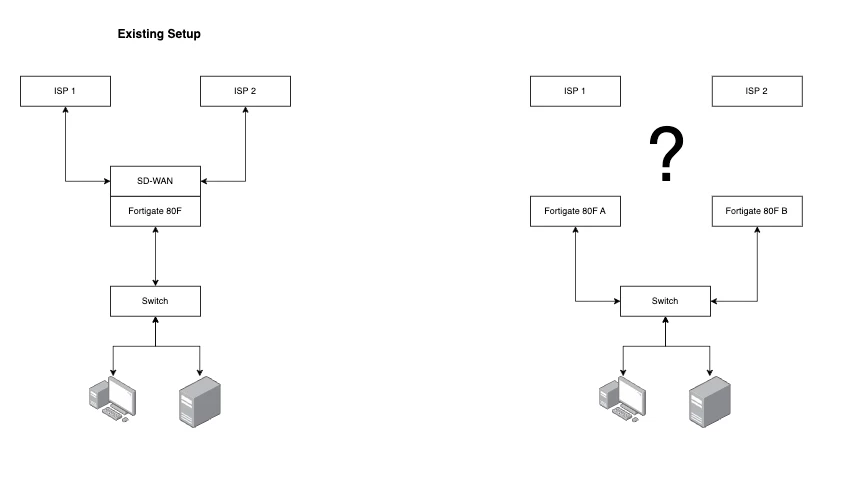

Hello! I'm working on an exciting network improvement project to implement High Availability (HA) in my environment by adding a second Fortigate appliance.
Currently, I have a single Fortigate 80F that's efficiently managing two WAN interfaces through SD-WAN. This setup allows me to create custom rules for routing specific devices through different WANs and provides automatic failover if either ISP experiences downtime.
I would need to enhance this setup by implementing a second Fortigate appliance to ensure network continuity even if one Fortigate unit fails. I'm curious about the best approach to achieve this - would it require any additional hardware like switches?
I'd greatly appreciate any guidance on implementing this redundant setup.

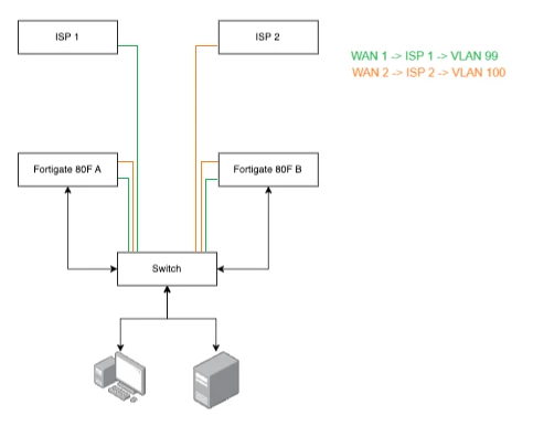

You could create transit VLAN's for the two ISPs on the switch you have in the second diagram, in which the ISP routers and the WAN ports on the 2 FortiGates will uplink into. This is the easiest way to achieve this but you now have a single point of failure in the switch.
You could build on this by uplinking into multiple switches tor additional resilience, but that all depends on your setup and budget.
Toshi_Esumi
November 14, 2024
I would add a direct cable between two 80Fs to @cjackson_ncl 's diagram for heartbeat connection without going through the switch, if they're close to each other.

Yes this also. Apologies I had assumed this would be the case anyway
