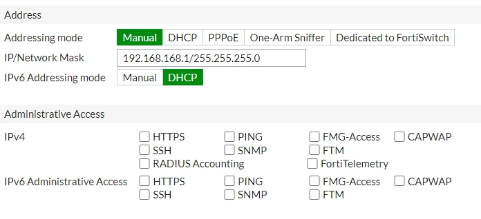

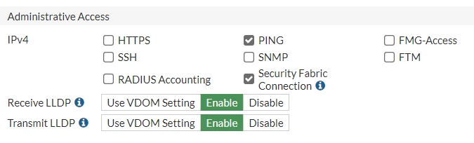

Hi All,
may i know how come the check box of Security Fabric Connection is missing in my forti 200D, but i can find in 200E
200D
[size="5"]200E[/size]

    GDiFi
    November 17, 2021
    My guess is you are running 6.4 on your 200E while on your 200D you are running and older firmware version.  There was a change in 6.4 to the Access options:
    https://community.fortinet.com/t5/FortiGate/Technical-Tip-Security-fabric-connection-setting/ta-p/196659?externalID=FD48916
    Debbie_FTNT
    November 17, 2021
    Hey @steve2688
    Security Fabric connection is a combination of the CAPWAP and FortiTelemetry settings, as noted in the KB linked by @GDiFi .
    If you hover your mouse over the little 'i' icon next to Security Fabric Connection, the FortiGate GUI will inform you of that as well :).
    C-Gielen
    November 17, 2021
    Hi,
    On the 200d you will never find it. But use telemetry and capwap instead.
    Goodluck with your ap's!
