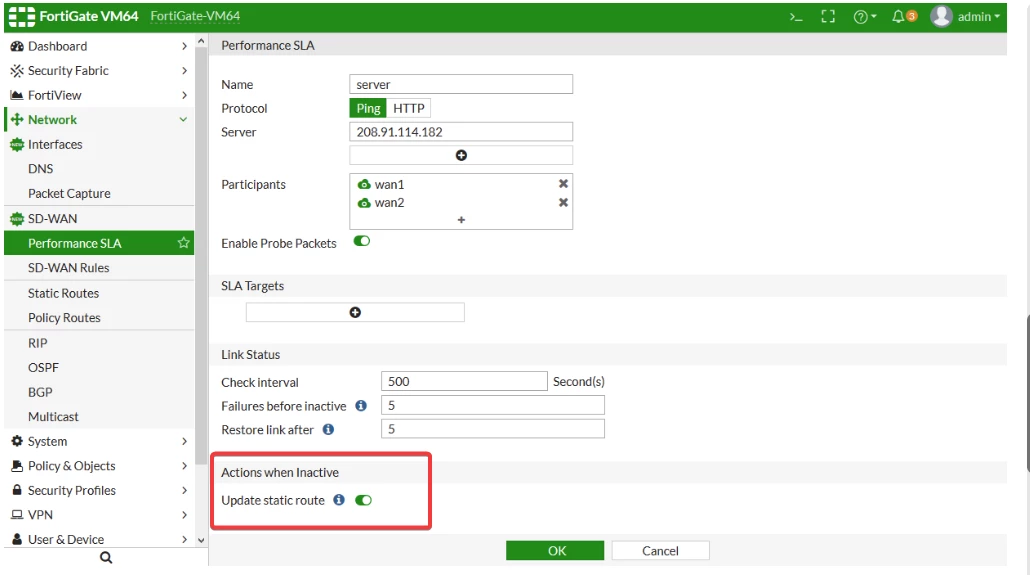

1) Do you have static IP address or DHCP/PPPoE on your ISP interfaces?
2) When you say ISP1 is down, do you mean that ISP1 is not able to route traffic but physical connection is up, correct?
3) How is your routing? Only static routing with default routes?
4) Do you have health-checks with update-static-route enabled?
For these cases, it is always good to perform debug flow when the problem is reproduced to see if the session was re-evaluated. And also examine routing-table before failure and during the failure to see if the routing-table acknowledged that there is some problem with ISP.

Can you please answer below questions :
-What is the current firmware version you are using on the FortiGate and Fortigate firewall model?
-How did you configure the sd-wan rules manually, based on sla performance?
-Do you have a static IP address or DHCP/PPPoE on your ISP interfaces?
-When you say ISP1 is down, do you mean that ISP1 is not able to get route traffic but the physical connection is up, correct?
- How is your routing? Did you configure routing based on individual static routes or via sd-wan interface, Only static routing with default routes?
-Do you have health checks with update-static-route enabled?
If you have not configured based on SLA then check the rules parameters of which process you choose. If you want to configure an automatic process refer below articles and configure based on the SLA parameter best quality.
articles :
https://community.fortinet.com/t5/FortiGate/Technical-Tip-Setting-up-ISP-Failover-with-Static-and-DHCP/ta-p/248510
https://docs.fortinet.com/document/fortigate/6.2.15/cookbook/723056/link-monitoring-and-failover
https://docs.fortinet.com/document/fortigate/6.2.15/cookbook/478384/performance-sla-link-monitoring
as mentioned earlier by my colleague @akristof  live traffic can give more information of behavior.
few logs you can consider collecting when an issue occurs:
# diagnose ip rtcache list
# get router info routing-table
# get router info kernel
# show full system sd-wan
# diagnose sys sdwan member
# diagnose sys sdwan health-check [health-check-name]
# diagnose sys sdwan service [service-id]
# diagnose sys sdwan intf-sla-log [interface-name]
# diagnose sys sdwan sla-log [health-check-name]
