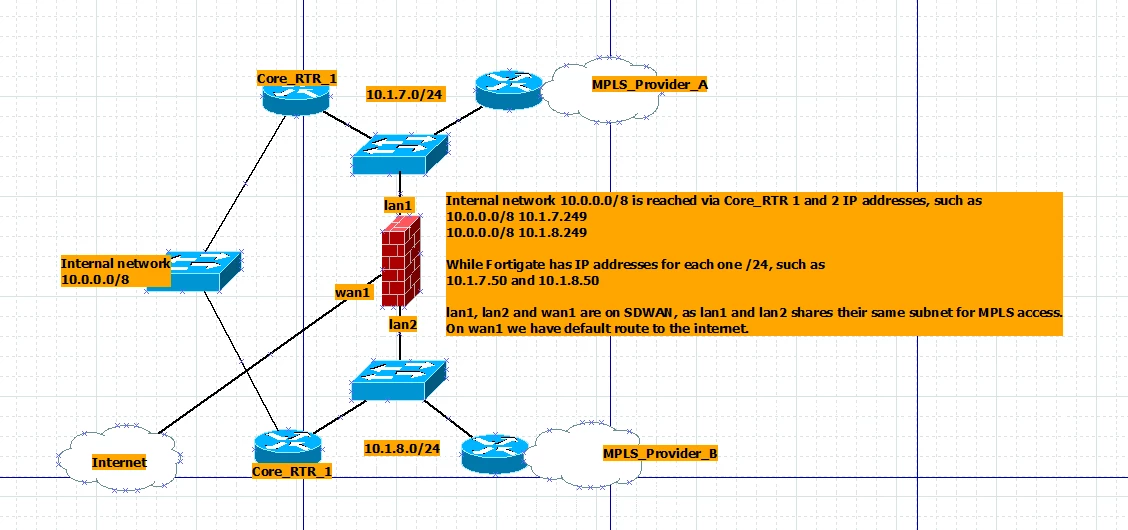

This might sound stupid/impossible or dumb question, but we have a customer asking us to route to his internal network by using the FGT physical interfaces which are in use by the SDWAN.
Instead of doing segmentation between different networks, putting the firewall between LAN/WAN, customer demanded to keep his original setup by using their respective /24 each interface, and then routing traffic towards his internal network to the core routers inside these /24 links, with the internet access (another interface, with default route) is still on SDWAN interface.
Is that possible? Would segmentation (by specifying interfaces, each one on their respective network and break between SDWAN/LAN) resolve this?
Attached, here's the topology:
