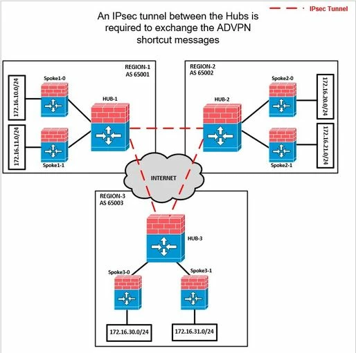

Hello,
I have to design a network based on sdwan, ibgp and advpn technology by the book, but using three hubs instead of the classical two.
It is possible to implement advpn based on three hubs?
Thank you all
Vincenzo Stolfi
Best answer by atakannatak
Hi @vincenzo ,
In a typical ADVPN setup with two Hubs, eBGP is used for exchanging ADVPN packets between the Hubs. This approach ensures clear separation of routing information, as iBGP is already managing routing between the Hub and Spokes within the same region. However, if OSPF is used between the Hub and Spokes, then iBGP can be used between the HUBs instead of eBGP.
Although this setup hasn't been tested in a lab on myside with three hubs, a similar two-hub deployment has been successfully implemented. If properly configured, extending the design to three hubs should be scalable and achievable.
Given that a standard ADVPN structure is already in place and Hub-Spoke communication within the same region is functioning correctly, the key challenge is integrating a third HUB into the design while maintaining optimal routing and failover mechanisms.
  • In a multi-HUB ADVPN setup, the set auto-discovery-forwarder enable command must be configured in the Phase 1 settings of the existing IPsec tunnels to allow ADVPN packet forwarding between HUBs. By default, ADVPN dynamically establishes Spoke-to-Spoke tunnels when a Spoke detects traffic destined for another Spoke. However, when there are multiple HUBs, the HUBs must forward ADVPN signaling packets between each other to ensure Spokes can discover the optimal path.

  • In an ADVPN setup, to enable spoke-to-spoke communication across different regions, you should adjust the IPsec Phase 1 settings by using set net-device enable. This allows dynamic routing protocols like OSPF or BGP to function properly, enabling the establishment of multiple tunnels with distinct IP addresses for more flexible routing.
  • You will indeed need to configure 3 separate IPsec tunnels to connect each HUB to the others. I mean each pair of HUBs requires a dedicated site-to-site IPsec tunnel. This ensures that each HUB can communicate with the other HUBs in the network. This is necessary because the ADVPN model assumes that traffic between HUBs will be routed through these tunnels using dynamic routing protocols (BGP/OSPF) to ensure proper route advertisement.
I hope this provides you with a useful perspective. Since testing this scenario in the lab will take some time, I will test it when I get the opportunity and will report the results to you separately.
