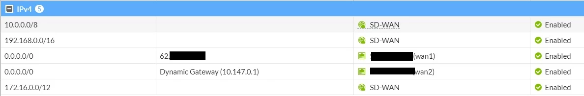

Hello,
a year ago I solved the same problem with TAC. Since self-originating traffic in version 6.2.2 and higher does not pass SD WAN - https://kb.fortinet.com/k....do?externalID=FD47380 - it is necessary to change DR. But..in all KB and CB from Fortinet, it is stated that when using SD WAN, only one DR per SD WAN is required - which is obviously not always true... So if there are some IPsec tunnels in SD WAN that connect local ranges (eg HQ and BR), it is necessary to place these IP local address ranges into Static Routes and set DR to the net (WAN1 and WAN2) directly to the gateway of the upstream router. I had no other explanation from them. But the ticket says: Bug fix already available. From this I understand that it is probably a bug and will be fixed. But who knows .. Anyway, now everything seems to work correctly (I will try it in detail tomorrow). This is how my routing table looks like now (FTN support used all RFC1918 address)
