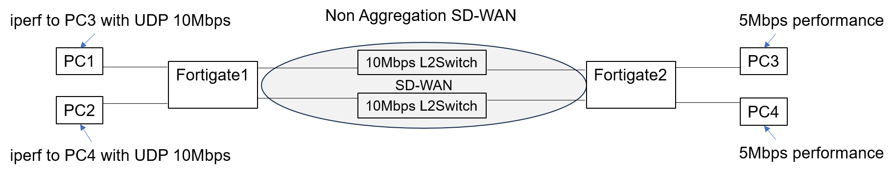

Are multiple lines used simultaneously at non-aggregation SD-WAN?
Here is my situation.
Between SD-WAN Fortigates, there are L2 switch which limits 10Mbps bandwidth.
iperf with UDP 10Mpbs runs at PC1 and the server is PC3.
iperf with UDP 10Mpbs runs at PC2 and the server is PC4.
However, only 5Mbps is seen at both PC3 and PC4. That is, only 1 line seems to be used.

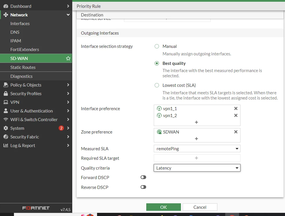

Here is SD-WAN rule setting.
How should I do in order to use simultaneous lines at non-aggregation SD-WAN?

Hi,
If you are not using Maximize bandwidth (FortiOS 7.2 or lower) or using load-balance option within the SDWAN rule (7.4 or higher) only one line will be used. More here:
https://docs.fortinet.com/document/fortigate/7.4.5/administration-guide/708464/load-balancing-strategy

I use v7.4.5. I do not intend to select load-balance. (I select "best performance", as seen in my previous post.)
How can I configure in order to use multi lines simultaneously?

October 21, 2024
With best performance you will not be able to use multiple links for load balancing. Idea behind the best performance sdwan rule is to use THE best link (only one best link available). You would need to use either lowest cost SLA or manual SDWAN rule to enable load-balance.
