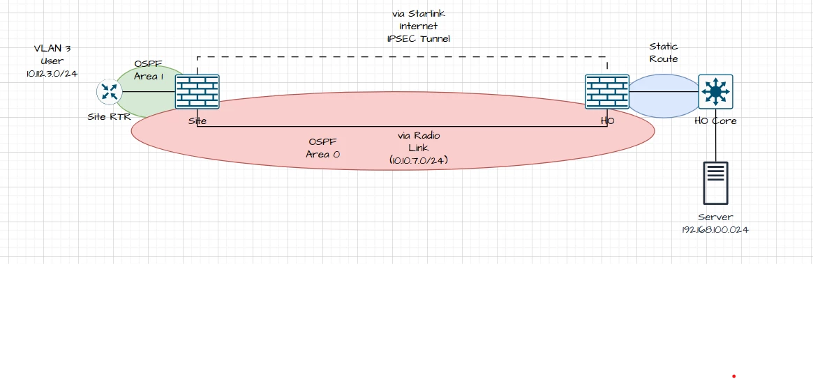

I have a case in my office, which is to setup SD-WAN between two Fortigate site office and Head Office (HO). we use two links, one is a local radio link via connection provider (L2) and another one is through IPsec Tunnel via internet (Starlink). Can someone point me a guide for this? because i already tried the guide below, but it doesnt seems to fit the purpose, since one of the links are just a LAN.
Technical-Tip-Configure-IPsec-VPN-with-SD-WAN
Also, kinda confused with the local and remote address in ipsec sdwan, should we create all the IP subnet in the routing table as a remote address in ipsec configuration?
below i attach the simple topology.
Thanks before.

Hi Gafar,
Did you see this link:
https://docs.fortinet.com/document/fortigate/7.4.1/administration-guide/402352/network-topologies
I guess you should find what you're looking for....
Otherwise, find below a very basic site-to-site IPsec configuration that you could fine tune regarding your needs.
    edit "Tun0"
        set interface "port2"
        set ike-version 2
        set peertype any
        set net-device disable
        set proposal des-sha1
        set dhgrp 14
        set nattraversal disable
        set remote-gw 210.0.X.X
        set psksecret ENC xxxxxxx
    edit "Tun0"
        set phase1name "Tun0"
        set proposal des-md5 des-sha1
Regards
Fab-S
February 23, 2025
After that, you have to add your IPsec Interface as a member and create a zone in which you place your members (IPsec interface and other).
This second step is described here: https://docs.fortinet.com/document/fortigate/7.4.1/administration-guide/942095
