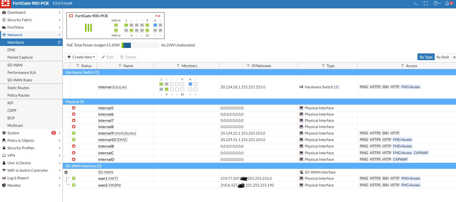

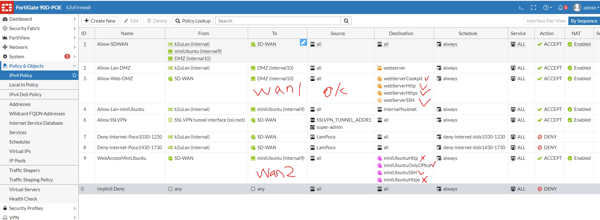

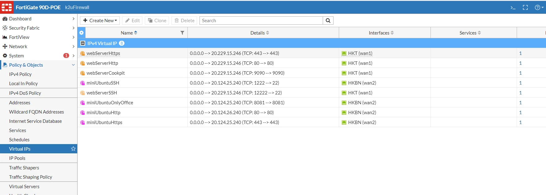

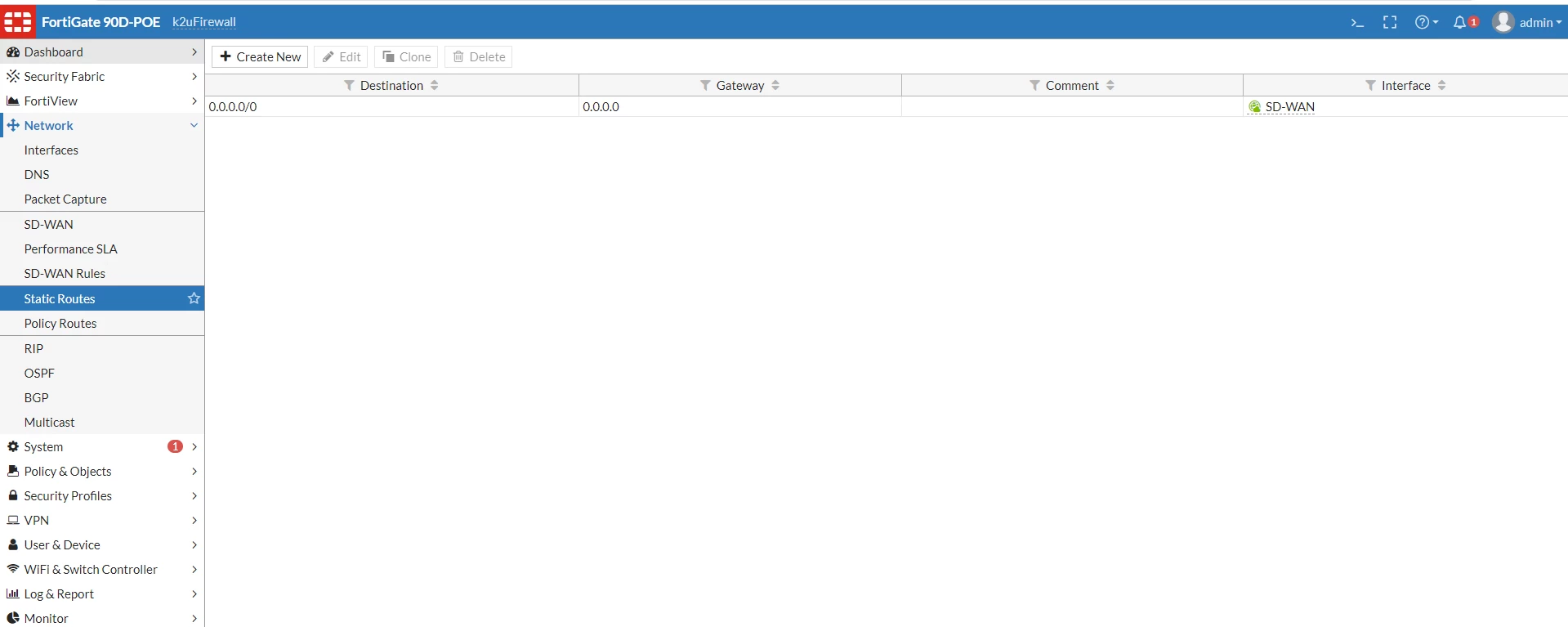

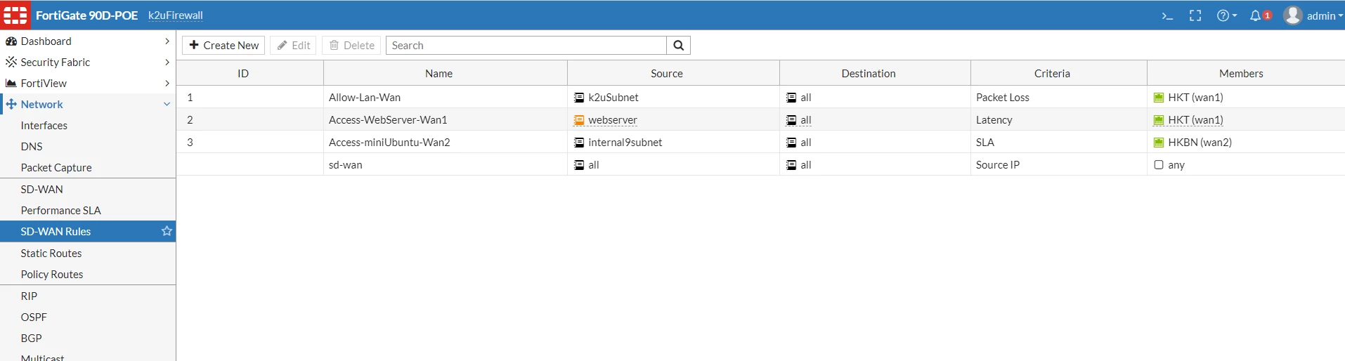

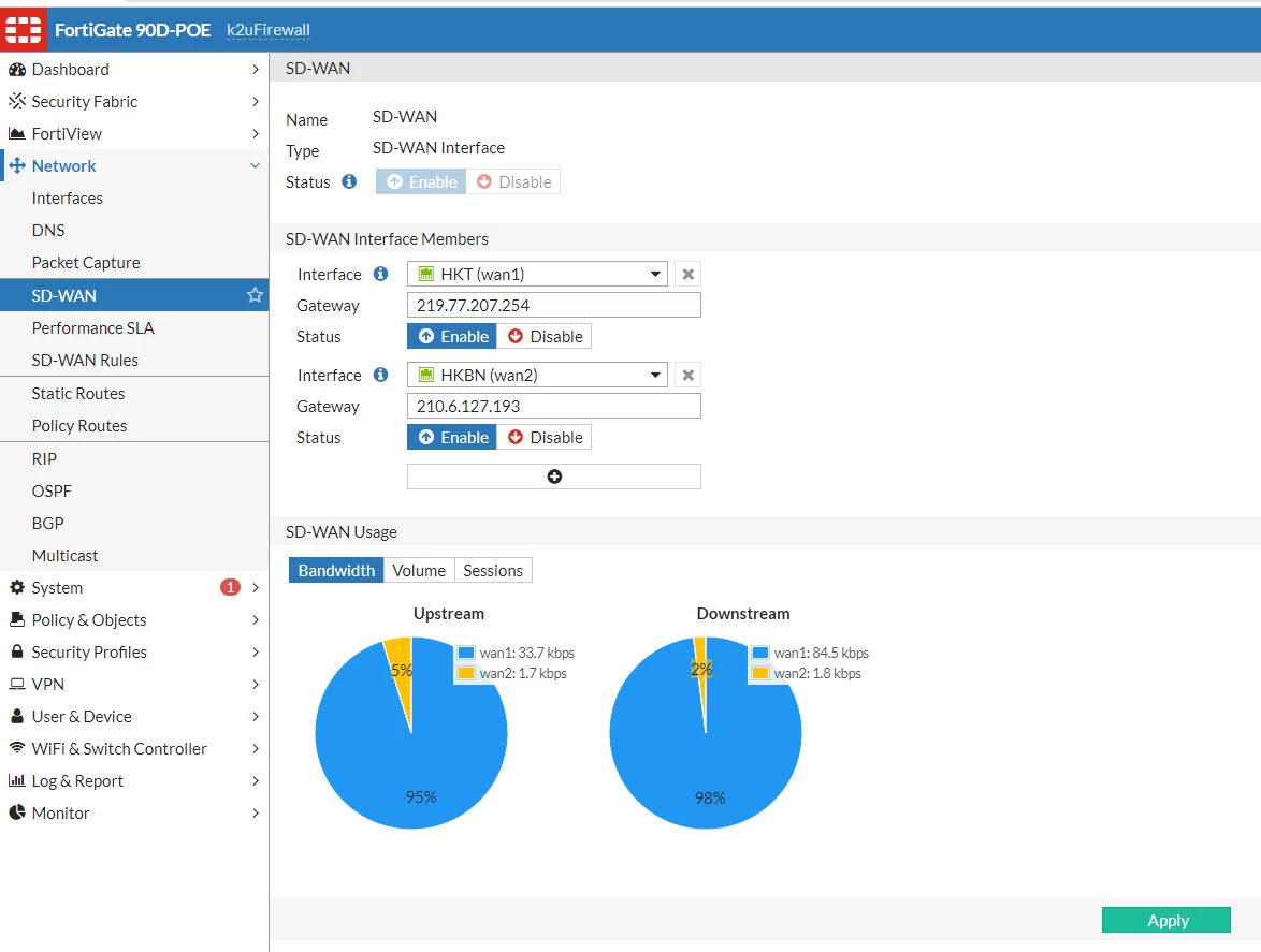

Hi,
Thank you for your replies, here are captured pictures of my fortigate rules setting, actually I'm quite new to fortigate, I don't know how to capture the txt config for you, if this is not enough, please let me know, thank you.VIP policiesVIP policiesVIPsVIPsPhysical InterfacesPhysical InterfacesSD wanSD wanSD wan rulesSD wan rulesStatic RulesStatic Rules

Hello,
I just did it, I think I made a stupid typo error on my policy forwarding for wan2 port 80 --> 20.124.26.240, should be 20.124.25.240; Everything is working fine now.  Thank you for everyone's comment and help.
