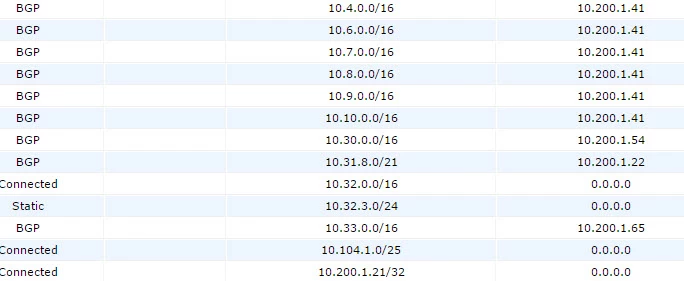

I have a VPN tunnel between two Fortigate devices. A 110C to a 600C. In Router > Monitor > Routing Monitor for some reason I am missing a BGP route. Which means the Fortigate does not know how to forward traffic when this missing route is the destination. I do however have all my other BGP routes showing up. I have another site set up with the same tunnel only it' s a 310B to a 600C. The route does show up in the Routing monitor. Not sure what I need to do to have BGP advertise this route properly. The route should show 10.101.0.0/16

    Hello, you can check if the route are correctly learned from BGP using the following commands: get router info bgp network 10.101.0.0/16 if the route is missing from the previous command, then check that the network is advertised by the peer: get router info bgp neighbors <a.b.c.d> received-routes If routes are correctly received, check if it has been pushed to the RIB: get router info routing database. Best regards, Benoit_Rech_FTNT
