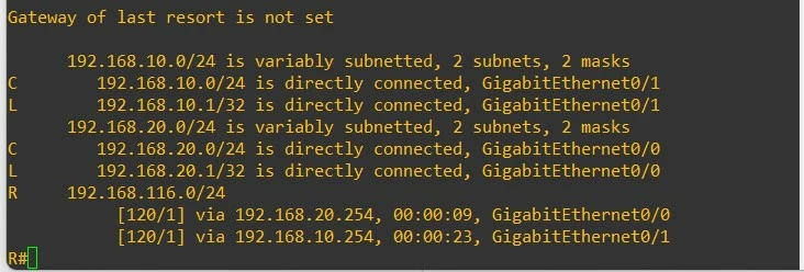

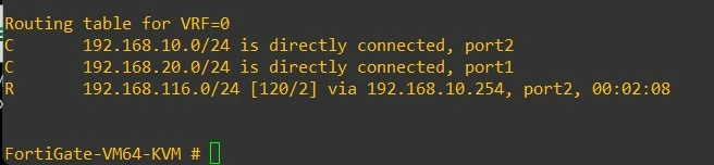

Hi - hoping someone can help me with this seemingly simple problem. Coming from the Cisco world we are replacing two of our routers with two FortiGate firewalls in HA active-passive mode.
My knowledge of the FortiGate configuration is limited (but growing). I'm currently trying a basic configuration with 1 PC connected to 1 switch which is connected to one FortiGate with two connections. Currently only one of the two networks on the Fortigate is reachable (192.168.10.1).
I've setup an identical configuration but instead using our cisco router and as you can see in the routing table it is logging the 192.168.116.0 route reachable via the two routes. The Fortigate is only showing this route via port2 even though it is also technically reach able via port1. I'm assuming this is the reason I can only reach the network from the port2 link and not the port1 ip of 192.168.20.1.
If this is the reason how can I populate the route to 192.168.116.0 via either port1 or port 2 instead of just port 2 - same as the cisco routing table.

Cisco Routing table
Fortigate replacing the cisco
Fortigate routing table
Best answer by Richie_C
I think the problem is the same. if you don't have a route in the routing table when the FortiGate receives the packet, It will fail the RPF (reverse path forwarding) check and drop the packet.
I do not believe that you can have 2 RIP routes in the routing table. As mentioned, It is only possible with static/ospf/bgp.
If you have a lab, then confirming it with 2 static routes would confirm the behaviour.

Hi - If i understand correctly, you are talking about equal cost multipath (ECMP).  The feature allows you to load-balance across multiple links:
https://docs.fortinet.com/document/fortigate/6.4.5/administration-guide/25967/equal-cost-multi-path
Only static/ospf/bgp routes are supported for this feature. So RIP isn't going to work I'm afraid.

You could confirm this behaviour by trying it with 2 statics.

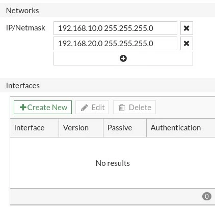

The two static routes did resolve the issue however I'd like to ask in the GUI what is the use of this "interface" box under RIP?
Also is there a technical reason why Fortinet doesn't allow multiple routes via RIP while other vendors do but allows this via OSPF? Just curios because while creating all our static routes on our firewall is doable it is kind of a pain!

Running the following commands from the CLI should also confirm what is happening:
diagnose debug enable diagnose debug flow filter saddr <source address> diagnose debug flow show fun enable diagnose debug flow show ip enable diagnose debug flow trace start 5
Toshi_Esumi
May 16, 2022
Not sure about your topology. FWs generally block traffic coming back from a different interface from the destination from the interface it sent out outgoing traffic to the same destination, unlike routers (Cisco, etc.). You probably need to change your network topology to avoid that. For example, if the device has 10.254 and one has 20.254 are the same device (switch?) connecting to 116.0/24 network, you can consolidate them as one link like using LAG/LACP if you're concering about the bandwidth and redundancy.
