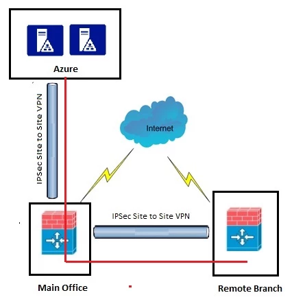

This my scenario:
We have 2 offices, Head Quarters and a remote branch. These two sites are connected with IPsec Site to Site vpn. Servers and services in the HQ are accessed by the remote branch using this vpn. Recently we acquired Azure services. We placed some of the servers in azure. HQ and Azure have a route based site to site vpn connection. So servers in azure are accessible in HQ. My problem is with the remote branch, it cannot access the servers in Azure. Although this can be resolved by creating a site to site vpn between Azure and remote branch but, management is reluctant in doing that as it involves another cost. To resolve this problem, I was thinking of using the existing vpn  tunnel of JHO and Azure. So basically access from remote branch will pass through the vpn tunnel to HQ and then pass to the vpn tunnel to Azure (please see illustration in red line). Can someone please give me the direction on how to achieve this, or if this even possible with my current Fortigate devices.
HQ Fortigate Device: FG 200E
Remote Branch Fortigate Device: FG 50E
Network illustration

Hi john
please follow the below step.
1. add a new route in your branch firewall.
    destination --> Azure local ip ( eg: 10.30.0.0/24)
    device -->vpn tunnel to HO
    distance --> any
2. Create a new Ip pool with any free IP from HQ ip range in HQ firewall ( if HQ ip is 192.168.0.0/24 then create a new ip pool with 192.168.0.254). IP pool can create under firewall-->ippool
3. create a policy in HO firewall from Branch(fortigate 50E) VPN interface to Azure VPN interface and enable NAT with Dynamic and point created NAT ip pool
now when you try to access the Azure address from branch it will route through ipsec tunnel and traffic will pass with HQ ip (192.168.0.254) which is trusted by Azure.
please check and update.
