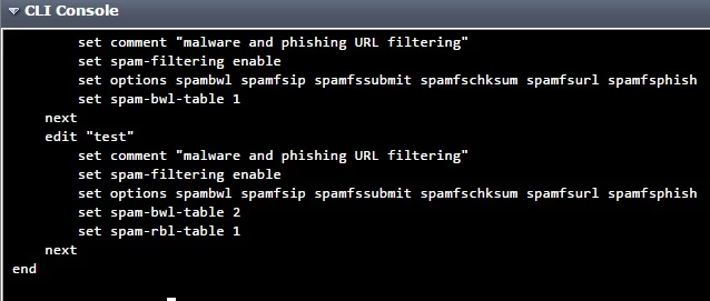

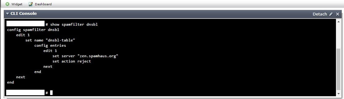

    i am using Fortigate 200D , running firmware 5.2.3. kindly check my configuration in the screen shot

    F200D# show spamfilter profile
    config spamfilter profile edit "Emailfil" set comment "malware and phishing URL filtering" set spam-filtering enable set options spambwl spamfsip spamfssubmit spamfschksum spamfsurl spamfsphish set spam-bwl-table 1 next edit "Emaifiltring" set comment "malware and phishing URL filtering" set spam-filtering enable set options spambwl spamfsip spamfssubmit spamfschksum spamfsurl spamfsphish set spam-bwl-table 2 set spam-rbl-table 1 next end
    F200# show spamfilter dnsbl config spamfilter dnsbl edit 1 set name "dnsbl-table" config entries edit 1 set server "zen.spamhaus.org" set action reject next end next end

    still does not see "enable":
    set status enable next end next end
    still does not see enable the function "spamrbl"
    config spamfilter profile edit "Emailfil" set options spambwl spamrbl spamfsip spamfssubmit spamfschksum spamfsurl spamfsphish
