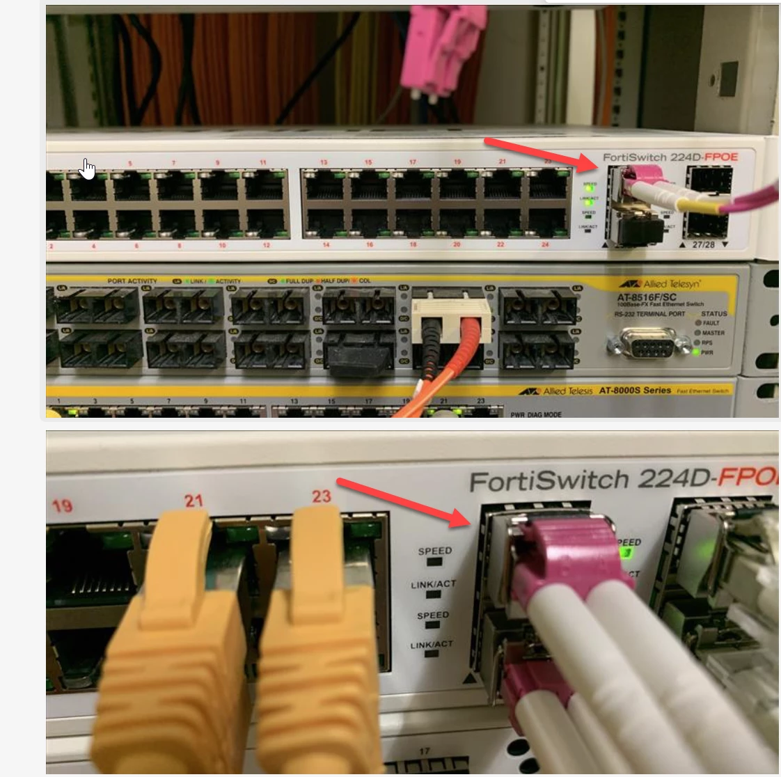

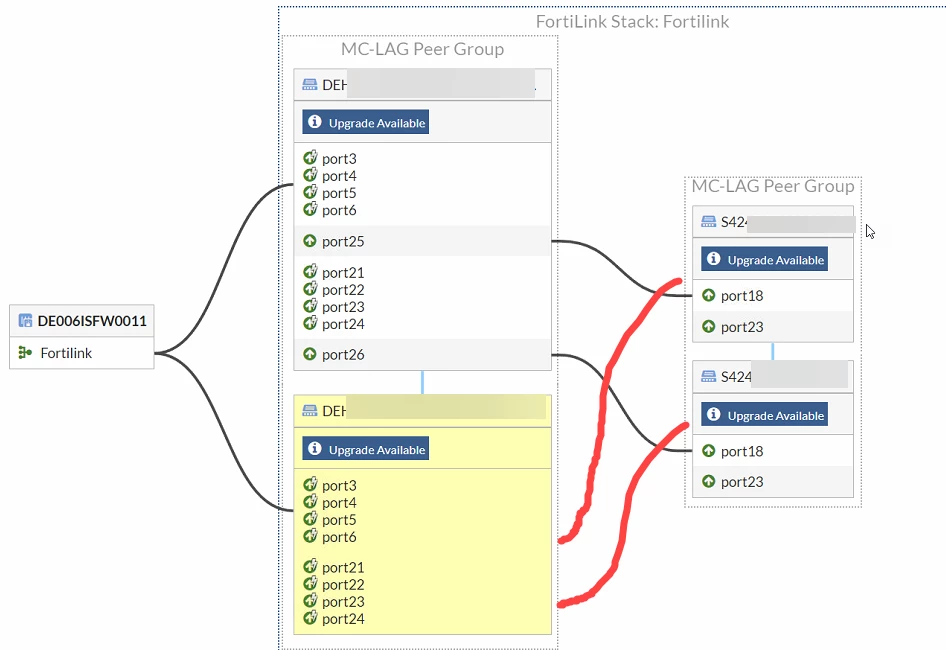

 I have a problem with one setup and I don't have any idea why links between switches are down

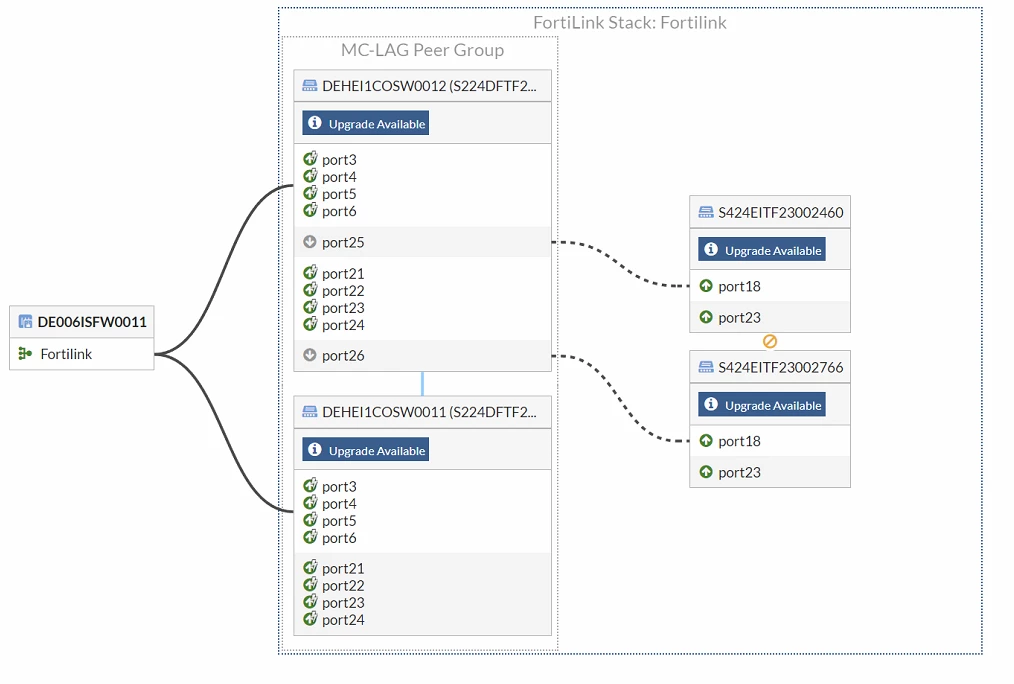

Those two red link are missed from fortilink. on lest switch ports 25 and 26 are connected , on right 17 on both.
Led not blinking. SFP modules replaced, fibers also. But what is really weird if I put ports 25 and 26 on left top, right switches are still online
 I don't have any idea why those two links are not working. Tried also setup speed on left to auto, 1000auto,1000full, nothing help.
Tried also connect another forthiswitch to port 25 but still the same. on this switch led are not blinking but on second switch link is up and led are on.2023-12-03_10-05-35.png
Transceivers are recognized correctly

Regarding your issue, I didn't try connect MLAG to MLAG before, but I think it is normal behavior to prevent loop.
Try remove connections from top left switch to right switches, just to see if the connections with bottom left come up.
