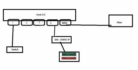

Hi,
Assistance with a network configuration. We have two internet modems in our current setup:
1. A fiber connection linked to the Forti WAN port.
2. A DIA with a static IP connected to Forti port number 4.
The internet is functioning correctly from the WAN port, now we need the user login to specified sites accessed exclusively through port number 4.

Hi @ATOON ,
I believe you can achieve that by configuring static routes to those destinations and use the DIA connection (port4) as exit interface.

Toshi_Esumi
April 5, 2024
If the sites' IP won't change, the easiest way is to find out IP of the site by pinging Site1/2.com, and set two static route to those two /32 destinations toward port4. Then you need a general NAT policy toward port4 in addition to you already have twoard wan.
Since the default route is still pointing toward wan while only two /32 destinations are pointed toward port4, all other destinations should follow the existing policy toward wan.

Thanks for your message, IP of the sites is changed, need configure by FQDN

Hello
If I understand well you need to:
  • Route access from internal user to siteA and siteB through port4
  • Route all other internet access through WAN port
Right?
Then you can for example integrate port4 and WAN interfaces in SD-WAN and configure all the above rules in a very simple way.
You can start here:
https://docs.fortinet.com/document/fortigate/6.4.15/administration-guide/889544/sd-wan-quick-start

Hi bro,
I followed the method you're mentioned in the above link, but I did not find in the method mentioned the way to add the sites that I wanted to open on port no# 4.

Hi Atoon
You specify the FQDN (site1.com, site2.com) in the Destination > Address field, and in the Interface Preference field you select port4.
