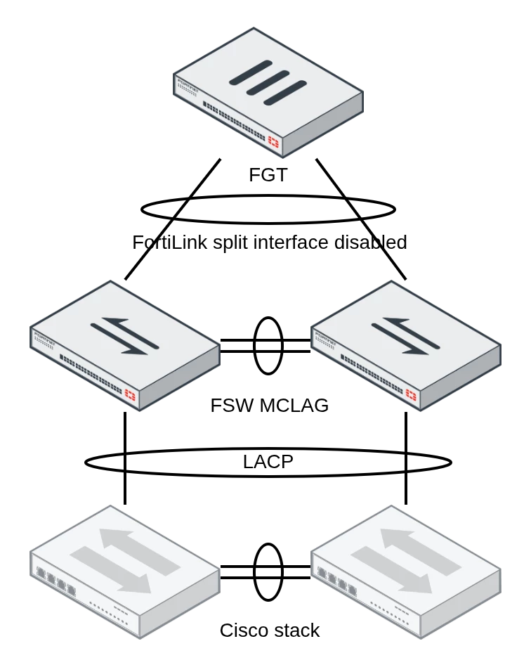

FS-448E supports MCLAG. You can integrate X1 and X2 in an active-active FortiLink on FGT, and connect them to your FortiSwitches.
Something like this would be fine.

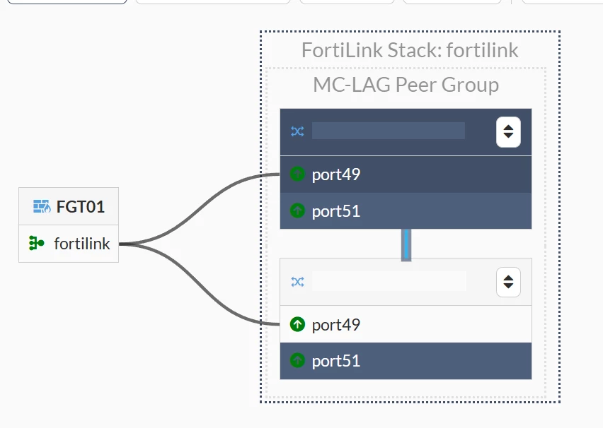

I have another question regarding the (MCLAG) between the two 448E Switches.
My idea for the cabling would be as follows:
Fortigate 100F X1 -> 448E #1 Port 49 (10G SFP)
Fortigate 100F X2 -> 448E #2 Port 49 (10G SFP)
MCLAG:
448E #1 Port 51/Port 52 (10G SFP) -> 448E #2 Port 51/Port52 (10G SFP)
Uplink LCAP to Upper Floor CBS350 stacked
448E #1 Port 50 (10G SFP) -> CBS350 #1 XG1(10G SFP)
448E #2 Port 50 (10G SFP) -> CBS350 #2 XG1 (10G SFP)
However, this presents the issue that all 10G ports on both 448E are in use.
I require at least one additional 10G port on one of the 448E for another switch in a different part of the building.
So the question is, does the MCLAG have to need of 2x 10G, or would 1x 10G be sufficient?
In addition, I am planning to replace the two CBS350 stacked on the upper floor with also 2x 448E at the end of the year. What would be the sensible cabling solution here?

Hi Fabs
Yes you can use one single link to inter-connect the two FSW. Two is good for redundancy but 1 will work fine.

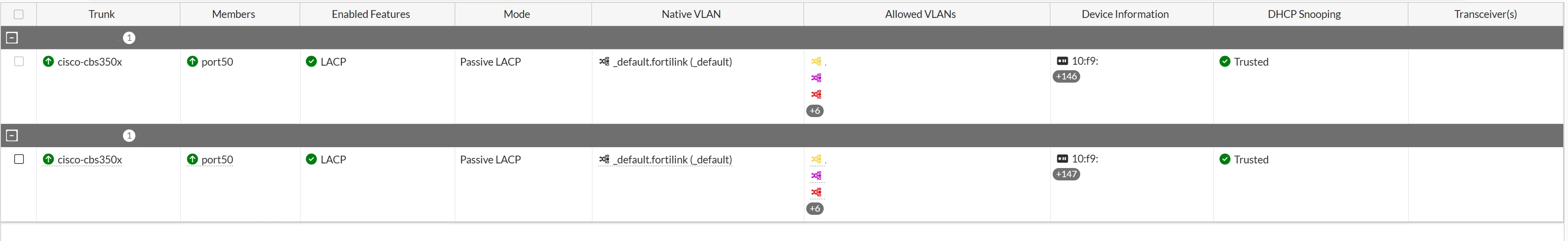

If I now connect the new pair of 448Es to the current pair of 448Es, will this automatically configure itself as LACP (802.3ad), as from the first pair of 448Es to the FortiLink interface on the Fortigate, or do I have to configure it as a trunk port (LACP) on both 448Es, as I am currently doing with the Cisco switches?
