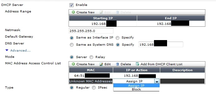

i swore i was able to do this before, but is there a way to block a device (or even better yet all mobile devices) on a certain SSID and only allow them on the other SSID?
foritnet 100d (5.4) with 4 FP221B-v5.4. we have our guest network (which i want the mobile deivces to use) and our network side SSID, which a few people seem to seem connect to since they know the password.

    If this was on 5.0.x codebase, you would create a standard DHCP server for the wifi SSID, and set the Unknown MAC Address" option to either assign or block.  I am assuming it is still the same/similar option on 5.4 firmware.

    thank you, i did figure that part out after i posted - same way on 5.4 pretty much.  i need to readup and see if i can block all mobile devices on a SSID from joining

    It seems the MAC address access control list option has been removed from firmware 5.2.5
