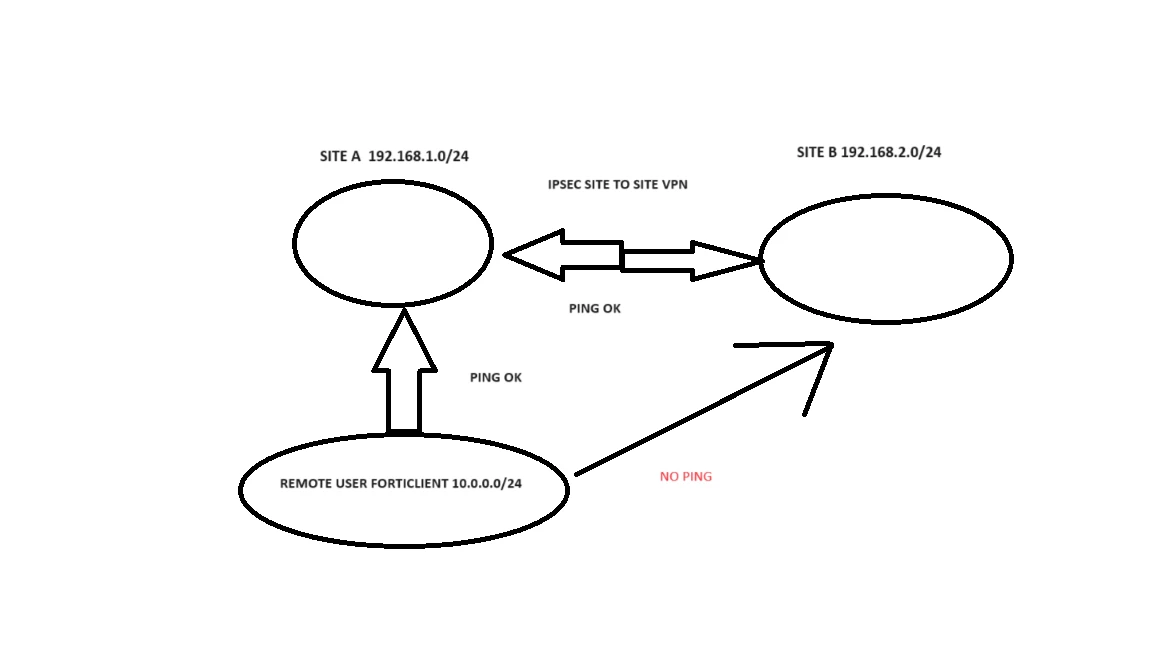

I have two routers connected using ipsec site to site.
The remote user connects to router A  (192.168.1.0/24) and has access to the network. The remote user does not have access to network B ( 192.168.2.0/24) How to make it have access to network B

Hi @jacm ,
If you have phase 2 selector configured on IP Sec tunnel, you will have to add the SSL VPN IP Subnet in the phase 2 selector on both sides of the tunnel.
You also need to create 2 firewall policies SSL VPN--> IP Sec and IP Sec to SSL VPN on Site A
In the firewall policies on Site B, you have to add the SSL VPN IP Subnet in the IP Sec --> internal firewall policy
You have to add a static route on Site B with destination as SSL VPN Subnet and exit interface as IP Sec tunnel.
Hope that helps.

Hi @jacm ,
Hope that helps.
