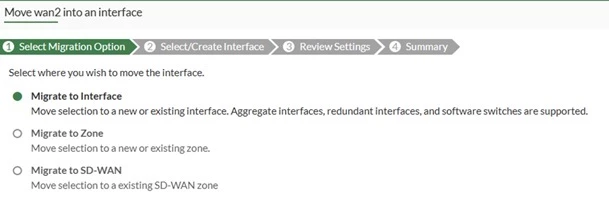

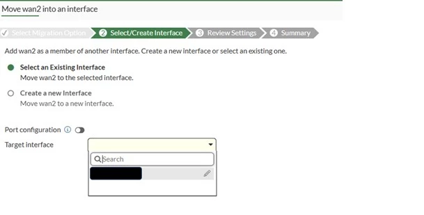

    Hi ​@yasushiazami ,
    Initially, I encountered the same issue in the LAB environment using the default configuration.
    After verifying WAN2, I observed that it had reference 0 but still it was not appearing under the aggregate interface.
    Further investigation using the CLI command `wan2 configuration` revealed that the mode was set to DHCP, with IPv6 mode and allowaccess enabled.
    By removing these configurations, the WAN2 interface then appeared correctly under the aggregate interface.
    Can you check once and remove the configuration if you are observing the same?

    I reset the device and followed the suggested procedure, and it worked perfectly!!
    Thank you everyone!!!
