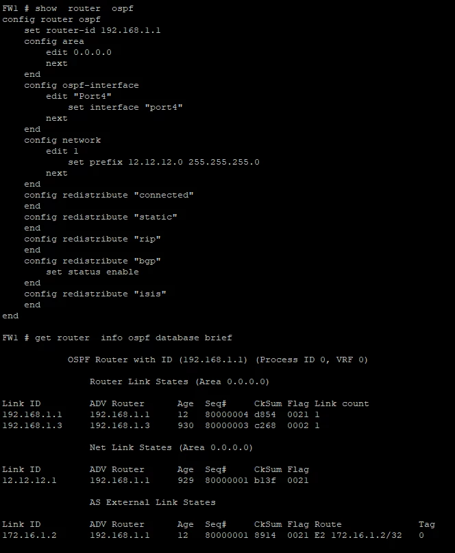

I set up three FGTs and one side is iBGP peering and the other side is OSFP peering and, of course, the middle one is redistributing from iBGP to OSPF. The config snippet at the middle FGT is below. 192.168.150.0/24 is advertised from iBGP neighbor. So I set a filter to allow only this prefix to be redistributed to OSPF side.
config router bgp
  set as 64512
  set router-id 10.10.1.2
  config neighbor
    edit "10.10.1.1"
      set next-hop-self enable
      set soft-reconfiguration enable
      set remote-as 64512
<snip>
config router ospf
  set router-id 10.10.11.2
  config area
    edit 0.0.0.0
  config network
      set prefix 10.10.11.0 255.255.255.252
  <snip>
  config redistribute "bgp"
    set status enable
    set routemap "allow_192_168_150_only"
  <snip>
The result was below:
<both at ASBR FGT and OSPF neighbor FGT>
FortiGate-60E # get router info ospf database brief
                OSPF Router with ID (10.10.11.2) (Process ID 0, VRF 0)
                   Router Link States (Area 0.0.0.0)
Link ID       ADV Router Age  Seq#        CkSum Flag Link count
10.10.11.1 10.10.11.1   748   80000005 e1e9    0012 1
10.10.11.2 10.10.11.2   1565 80000006 dde9    0021 1
                  Net Link States (Area 0.0.0.0)
10.10.11.2 10.10.11.2    1538 80000002 7365    0031
                  AS External Link States
Link ID           ADV Router Age Seq#         CkSum Flag Route                       Tag
10.253.240.0 10.10.11.1   1168 80000002 3786    0012 E2 10.253.240.0/20 0
192.168.1.0 10.10.11.1     98     80000002 8ab2    0012 E2 192.168.1.0/24   0
192.168.150.0 10.10.11.2 1565 80000001 198e    0021 E2 192.168.150.0/24 0
Conclusion:
iBGP learned routes are redistributed to OSPF side without any special command to allow, which is the case for Cisco. (Juniper's route redistribution is always going through RIB, not directly from iBGP to OSPF, so it wouldn't apply).
Toshi
