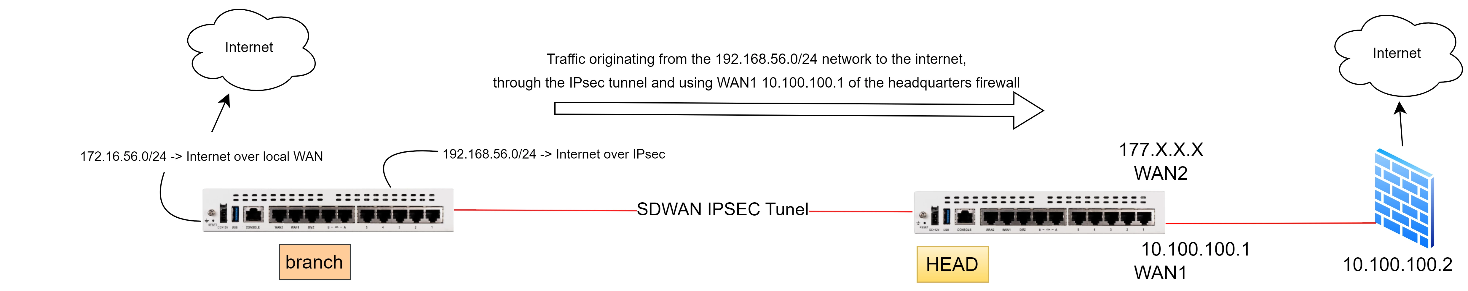

I am implementing a scenario in which I have branches connected to the headquarters through IPSec tunnels.
In my environment, I need to direct all traffic originating from the branch's local network through the IPsec tunnel so that this traffic destined for the internet uses the headquarters' WAN.
For other services at the branch, I need to use the local WAN link.
For example, branch office ether1, network 192.168.56.0/24, all traffic must be routed through the IPsec tunnel.
As for ether2, network 172.16.56.0/24, traffic must be directed through the local WAN.
I already have this working environment, I am using IPsec SDWAN to close the tunnels, make them redundant across different WANs and my question/problem is the following.
For traffic originating from the branch network, 192.168.56.0/24 and destined for the internet to work, I must have a static default route created in the headquarters firewall, with gateway to the WAN 10.100.100.2, without this, navigation will not be possible. It doesn't works, even using an SDWAN rule to route, only navigation through the tunnel works if I have this default route active.
The problem is that, for this WAN, 10.100.100.2, I need to direct ONLY the traffic originating from the units' remote networks, other traffic I cannot direct to it, that is, the default route becomes a problem in my case.
I have been researching, but so far I have not been successful in finding a configuration recommendation for this environment, in which I need to be able to somehow use WAN1 (10.100.100.2) as the default route only for specific source networks, in practice, I would like to use SDWAN for this, but it didn't work in my environment.
I would like to know what the community recommends in this case.

Hello,
Today the scenario already works, but for it to work, it is mandatory that I have a static route with 0.0.0.0/0.0.0.0 and gateway 10.100.100.2, to precisely direct traffic through the WAN2 of the headquarters.
However, this static route impacts my other accesses, such as traffic originating from Fortinet itself, for example.
My goal is to ensure that only traffic originating from remote networks uses the default route with gateway 10.100.100.2.
For this, I created SDWAN rules, but if I simply disable the 0.0.0.0/0.0.0.0 route, the branch traffic is not directed to WAN2 through the SDWAN rule.
