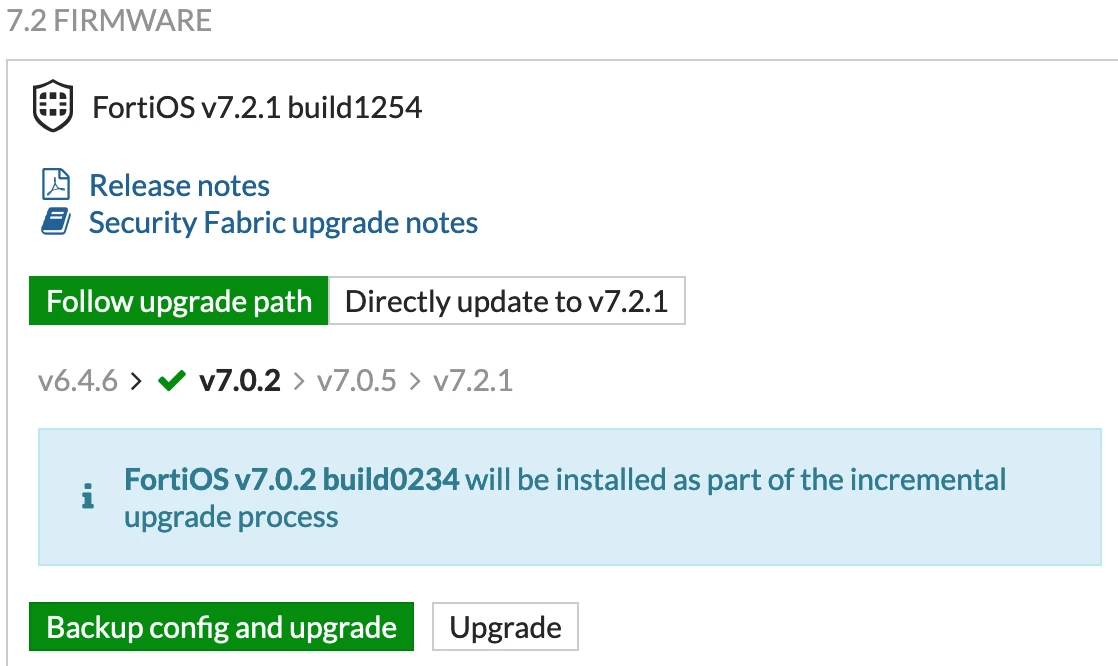

Great, thank you very much!  Is the upgrade path displayed in the UI accurate?  6.4.6 > 7.0.2 > 7.0.5 > 7.2.1?  Do I need to download the firmware or will that happen behind the scenes?  And do you have an idea how long it might take just so I can provide a rough estimate of availability?

If you want to upgrade to 7.2.1 then you have to download all the relevant firmwares and first you have to upgrade 7.0.2 and 7.0.5 and lastly you can upgrade to 7.2.1.
one upgrade can take around 10 to 15 min.
