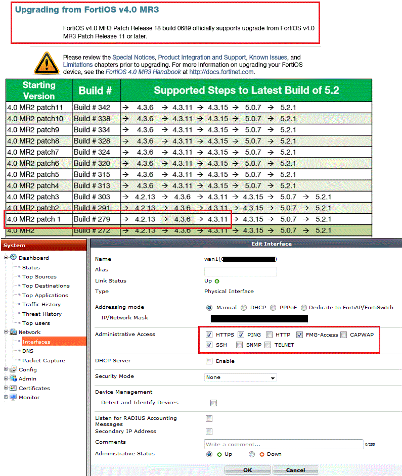

    Personally, I would have followed the upgrade path set forth by Fortinet; that said, I would ask the ground guy to check the "WAN" interface and admin options are configured correctly.  If it looks correct, then it may be possible the "WAN" interface is "flapping" (e.g. duplex/speed issue), which you can have the ground guy configure via the CLI.  At least this will get you into the fgt.
    config system interface edit "wan1" set speed 100full next end

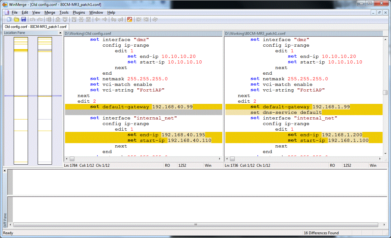

    Read the patch notes on any early 4.3.x release to see what the "gotchas" are when upgrading from 4.2.x to 4.3.x.  If you are downgrading the fgt, I advise loading a pre-4.3 backup config back onto the fgt.
    I do know from my own experience going from 4.1/4.2 ->4.3.x that the "scripted conversion" process on the config during major firmware upgrades doesn't handle non-standard chars (mainly space chars) in firewall object names/labels that well.  If you want to see what parts of the config has been changed during the firmware upgrade process, I suggest using something like WinMerge to compare config files from before and after the upgrade.
