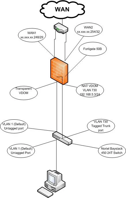

Problem with side by side NAT and Transparent VDOMs
  • May 5, 2010
  • 5 replies
  • 3746 views
Please, refer to the attached picture. Based on this picture, I am not able to get out to the internet. However, if I just take out VLAN 730 ethernet cable out of, just, fortigate' s internal interface port, I am able to get out to internet. Can somebody tell me where I went wrong? Thanks in advance

    What do your routing entries look like: 1) With VLAN 730 connected and 2) Without VLAN 730 connected

    For NAT VDOM ----------------------- Static Route Destination IP/Mask - 0.0.0.0/0.0.0.0 Device - wan2 Gateway - xx.xxx.xx.254 Distance (1-255) - 10 Priority (0-4294967295) - 0 For Transparent vdom there is nothing. Should I have specified the default gateway for transparent vdom? If yes, why does it work when there is only one vdom (transparent)?

    From the CLI
    # diag ip route list
    Or from the GUI ' Router > Monitor" . Look for any differences with that lead installed and removed...

    This is what I get when vlan 730 is pulled out of fg50b. I am able to get out to wan. tab=254 vf=0 scope=253 type=1 proto=2 prio=0 0.0.0.0/0.0.0.0/0->xx.xxx.xx.248/29 pref=xx.xxx.xx.254 gwy=0.0.0.0 dev=13(root.b) tab=254 vf=0 scope=253 type=1 proto=2 prio=0 0.0.0.0/0.0.0.0/0->192.168.8.0/24 pref=192.168.8.15 gwy=0.0.0.0 dev=13(root.b) tab=255 vf=0 scope=253 type=3 proto=2 prio=0 0.0.0.0/0.0.0.0/0->127.255.255.255/32 pref=127.0.0.1 gwy=0.0.0.0 dev=7(root) tab=255 vf=0 scope=254 type=2 proto=2 prio=0 0.0.0.0/0.0.0.0/0->xx.xxx.xx.254/32 pref=xx.xxx.xx.254 gwy=0.0.0.0 dev=13(root.b) tab=255 vf=0 scope=253 type=3 proto=2 prio=0 0.0.0.0/0.0.0.0/0->192.168.8.255/32 pref=192.168.8.15 gwy=0.0.0.0 dev=13(root.b) tab=255 vf=0 scope=253 type=3 proto=2 prio=0 0.0.0.0/0.0.0.0/0->xx.xxx.xx.255/32 pref=xx.xxx.xx.254 gwy=0.0.0.0 dev=13(root.b) tab=255 vf=0 scope=254 type=2 proto=2 prio=0 0.0.0.0/0.0.0.0/0->192.168.8.15/32 pref=192.168.8.15 gwy=0.0.0.0 dev=13(root.b) tab=255 vf=0 scope=253 type=3 proto=2 prio=0 0.0.0.0/0.0.0.0/0->xx.xxx.xx.248/32 pref=xx.xxx.xx.254 gwy=0.0.0.0 dev=13(root.b) tab=255 vf=0 scope=253 type=3 proto=2 prio=0 0.0.0.0/0.0.0.0/0->192.168.8.0/32 pref=192.168.8.15 gwy=0.0.0.0 dev=13(root.b) tab=255 vf=0 scope=253 type=3 proto=2 prio=0 0.0.0.0/0.0.0.0/0->127.0.0.0/32 pref=127.0.0.1 gwy=0.0.0.0 dev=7(root) tab=255 vf=0 scope=254 type=2 proto=2 prio=0 0.0.0.0/0.0.0.0/0->127.0.0.1/32 pref=127.0.0.1 gwy=0.0.0.0 dev=7(root) tab=255 vf=0 scope=254 type=2 proto=2 prio=0 0.0.0.0/0.0.0.0/0->127.0.0.0/8 pref=127.0.0.1 gwy=0.0.0.0 dev=7(root)

    OK. What do you show when you plug back in?

    Well, they appear to be identical... I don' t see any default gateway. (0.0.0.0/0)

    Why is the gateway 0.0.0.0/0? How do I specify default gateway for root vdom (transparent)? I tried to add it to routing table, but that didn' t help.
