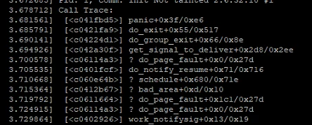

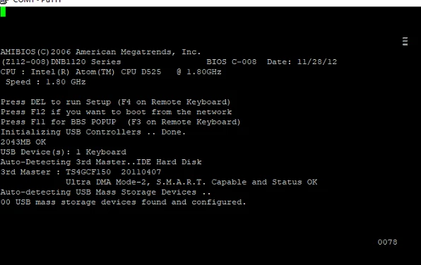

I have problem with Meru MC1550.  Device does not respond to ping...
I can connect via console cable, but I get errors... What can I do?
[ 2.119455] usbhid: v2.6:USB HID core driver
[ 2.123843] Netfilter messages via NETLINK v0.30.
[ 2.128635] nf_conntrack version 0.5.0 (16384 buckets, 65536 max)
[ 2.134982] ctnetlink v0.93: registering with nfnetlink.
[ 2.140463] TCP bic registered
[ 2.143591] Initializing XFRM netlink socket
[ 2.147938] NET: Registered protocol family 17
[ 2.152471] Using IPI Shortcut mode
[ 2.761588] ata1.00: SATA link down (SStatus 0 SControl 310)
[ 2.767338] ata1.01: SATA link down (SStatus 0 SControl 310)
[ 3.478989] ata2.01: failed to resume link (SControl 0)
[ 3.494968] ata2.00: SATA link down (SStatus 0 SControl 310)
[ 3.500716] ata2.01: SATA link down (SStatus 0 SControl 0)
[ 3.506317] md: Waiting for all devices to be available before autodetect
[ 3.513185] md: If you don't use raid, use raid=noautodetect
[ 3.519192] md: Autodetecting RAID arrays.
[ 3.523364] md: Scanned 0 and added 0 devices.
[ 3.527884] md: autorun ...
[ 3.530743] md: ... autorun DONE.
[ 3.539398] kjournald starting. Commit interval 5 seconds
[ 3.545816] EXT3-fs: mounted filesystem with writeback data mode.
[ 3.551998] VFS: Mounted root (ext3 filesystem) readonly on device 3:6.
[ 3.558710] Freeing unused kernel memory: 300k freed
[ 3.655651] init[1]: segfault at bf582070 ip b78da41e sp bfd81f88 error 4 in ld-2.5.so[b78d4000+1a000]
[ 3.665233] Kernel panic - not syncing: Attempted to kill init!
[ 3.671422] Pid: 1, comm: init Not tainted 2.6.32.10 #1
[ 3.677454] Call Trace:
[ 3.680308] [<c041fbd5>] panic+0x3f/0xe6
[ 3.684540] [<c0421fa9>] do_exit+0x55/0x517
[ 3.688883] [<c04224d1>] do_group_exit+0x66/0x8e
[ 3.693658] [<c042a30f>] get_signal_to_deliver+0x2d8/0x2ee
[ 3.699310] [<c06114a3>] ? do_page_fault+0x0/0x27d
[ 3.704266] [<c0401fcf>] do_notify_resume+0x71/0x716
[ 3.709388] [<c042067b>] ? printk+0x15/0x17
[ 3.713730] [<c0412b00>] ? __bad_area_nosemaphore+0xd5/0xe8
[ 3.719468] [<c0412b41>] ? __bad_area+0x2e/0x37
[ 3.724156] [<c0412b67>] ? bad_area+0xd/0x10
[ 3.728584] [<c0611664>] ? do_page_fault+0x1c1/0x27d
[ 3.733706] [<c06114a3>] ? do_page_fault+0x0/0x27d
[ 3.738655] [<c0402926>] work_notifysig+0x13/0x19
[ 3.743518] [<c06114a3>] ? do_page_fault+0x0/0x27d
â–’
[ 0.000000] Linux version 2.6.32.10 (root@phobos) (gcc version 4.1.2 20080704 (Red Hat 4.1.2-46)) #1 SMP Tue Jun 4 19:34:32 PDT 2013
[ 0.000000] KERNEL supported cpus::128M
[ 0.000000] Intel GenuineIntelze=0x1e3e20]
[ 0.000000] AMD AuthenticAMD
[ 0.000000] NSC Geode by NSC
[ 0.000000] Cyrix CyrixInstead
[ 0.000000] Centaur CentaurHauls
[ 0.000000] Transmeta GenuineTMx86
[ 0.000000] Transmeta TransmetaCPU
[ 0.000000] UMC UMC UMC UMC
[ 0.000000] BIOS-provided physical RAM map:
[ 0.000000] BIOS-e820: 0000000000000000 - 000000000009dc00 (usable)
[ 0.000000] BIOS-e820: 000000000009dc00 - 00000000000a0000 (reserved)
[ 0.000000] BIOS-e820: 00000000000e0000 - 0000000000100000 (reserved)
[ 0.000000] BIOS-e820: 0000000000100000 - 000000007fac0000 (usable)
[ 0.000000] BIOS-e820: 000000007fac0000 - 000000007face000 (ACPI data)
[ 0.000000] BIOS-e820: 000000007face000 - 000000007fae0000 (ACPI NVS)
[ 0.000000] BIOS-e820: 000000007fae0000 - 0000000080000000 (reserved)
[ 0.000000] BIOS-e820: 00000000fee00000 - 00000000fee01000 (reserved)
[ 0.000000] BIOS-e820: 00000000ffb00000 - 0000000100000000 (reserved)
[ 0.000000] DMI present.
[ 0.000000] AMI BIOS detected: BIOS may corrupt low RAM, working around it.
[ 0.000000] last_pfn = 0x7fac0 max_arch_pfn = 0x1000000
[ 0.000000] init_memory_mapping: 0000000000000000-00000000379fe000
[ 0.000000] 1152MB HIGHMEM available.
[ 0.000000] 889MB LOWMEM available.
[ 0.000000] mapped low ram: 0 - 379fe000
[ 0.000000] low ram: 0 - 379fe000
[ 0.000000] node 0 low ram: 00000000 - 379fe000
[ 0.000000] node 0 bootmap 00012000 - 00018f40
[ 0.000000] (8 early reservations) ==> bootmem [0000000000 - 00379fe000]
[ 0.000000] #0 [0000000000 - 0000001000] BIOS data page ==> [0000000000 - 0000001000]
[ 0.000000] #1 [0000001000 - 0000002000] EX TRAMPOLINE ==> [0000001000 - 0000002000]
[ 0.000000] #2 [0000006000 - 0000007000] TRAMPOLINE ==> [0000006000 - 0000007000]
[ 0.000000] #3 [0000400000 - 000085de54] TEXT DATA BSS ==> [0000400000 - 000085de54]
[ 0.000000] #4 [000009dc00 - 0000100000] BIOS reserved ==> [000009dc00 - 0000100000]
[ 0.000000] #5 [000085e000 - 00008641be] BRK ==> [000085e000 - 00008641be]
[ 0.000000] #6 [0000010000 - 0000012000] PGTABLE ==> [0000010000 - 0000012000]
[ 0.000000] #7 [0000012000 - 0000019000] BOOTMAP ==> [0000012000 - 0000019000]
[ 0.000000] found SMP MP-table at [c00ff780] ff780
[ 0.000000] Reserving 64MB of memory at 16MB for crashkernel (System RAM: 2042MB)
[ 0.000000] Zone PFN ranges:
[ 0.000000] DMA 0x00000010 -> 0x00001000
[ 0.000000] Normal 0x00001000 -> 0x000379fe
[ 0.000000] HighMem 0x000379fe -> 0x0007fac0
[ 0.000000] Movable zone start PFN for each node
[ 0.000000] early_node_map[2] active PFN ranges
[ 0.000000] 0: 0x00000010 -> 0x0000009d
[ 0.000000] 0: 0x00000100 -> 0x0007fac0
[ 0.000000] Using APIC driver default
[ 0.000000] Intel MultiProcessor Specification v1.1
[ 0.000000] Virtual Wire compatibility mode.
[ 0.000000] MPTABLE: OEM ID: Intel
[ 0.000000] MPTABLE: Product ID: MoonCreek
[ 0.000000] MPTABLE: APIC at: 0xFEE00000
[ 0.000000] Processor #0 (Bootup-CPU)
[ 0.000000] Processor #2
[ 0.000000] I/O APIC #1 Version 32 at 0xFEC00000.
[ 0.000000] Enabling APIC mode: Flat. Using 1 I/O APICs
[ 0.000000] Processors: 2
[ 0.000000] SMP: Allowing 2 CPUs, 0 hotplug CPUs
[ 0.000000] Allocating PCI resources starting at 80000000 (gap: 80000000:7ee00000)
[ 0.000000] NR_CPUS:8 nr_cpumask_bits:8 nr_cpu_ids:2 nr_node_ids:1
[ 0.000000] PERCPU: Embedded 11 pages/cpu @c6200000 s20696 r0 d24360 u1048576
[ 0.000000] pcpu-alloc: s20696 r0 d24360 u1048576 alloc=1*2097152
[ 0.000000] pcpu-alloc: [0] 0 1
[ 0.000000] Built 1 zonelists in Zone order, mobility grouping on. Total pages: 518743
[ 0.000000] Kernel command line: root=/dev/hda6 console=ttyS0,115200 ide_core.nodma=0.0 console=tty0 crashkernel=512M-2G:64M,2G-:128M
[ 0.000000] PID hash table entries: 4096 (order: 2, 16384 bytes)
[ 0.000000] Dentry cache hash table entries: 131072 (order: 7, 524288 bytes)
[ 0.000000] Inode-cache hash table entries: 65536 (order: 6, 262144 bytes)
[ 0.000000] Enabling fast FPU save and restore... done.
[ 0.000000] Enabling unmasked SIMD FPU exception support... done.
[ 0.000000] Initializing CPU#0
[ 0.000000] Initializing HighMem for node 0 (000379fe:0007fac0)
[ 0.000000] Memory: 2002928k/2091776k available (2125k kernel code, 87324k reserved, 1139k data, 300k init, 1180424k highmem)
[ 0.000000] virtual kernel memory layout:
[ 0.000000] fixmap : 0xfff20000 - 0xfffff000 ( 892 kB)
[ 0.000000] pkmap : 0xffa00000 - 0xffc00000 (2048 kB)
[ 0.000000] vmalloc : 0xf81fe000 - 0xff9fe000 ( 120 MB)
[ 0.000000] lowmem : 0xc0000000 - 0xf79fe000 ( 889 MB)
[ 0.000000] .init : 0xc0731000 - 0xc077c000 ( 300 kB)
[ 0.000000] .data : 0xc0613452 - 0xc0730138 (1139 kB)
[ 0.000000] .text : 0xc0400000 - 0xc0613452 (2125 kB)
[ 0.000000] Checking if this processor honours the WP bit even in supervisor mode...Ok.
[ 0.000000] Hierarchical RCU implementation.
[ 0.000000] NR_IRQS:512
[ 0.000000] Console: colour VGA+ 80x25
[ 0.000000] console [tty0] enabled
[ 0.000000] console [ttyS0] enabled
[ 0.000000] Fast TSC calibration failed
[ 0.000000] TSC: Using PIT calibration value
[ 0.000000] Detected 1799.871 MHz processor.
[ 0.007005] Calibrating delay loop (skipped), value calculated using timer frequency.. 3599.74 BogoMIPS (lpj=1799871)
[ 0.009082] Mount-cache hash table entries: 512
[ 0.011110] CPU: L1 I cache: 32K, L1 D cache: 24K
[ 0.013003] CPU: L2 cache: 512K
[ 0.014004] CPU: Unsupported number of siblings 4
[ 0.015005] using mwait in idle threads.
[ 0.016016] Checking 'hlt' instruction... OK.
[ 0.021738] Freeing SMP alternatives: 13k freed
[ 0.022129] ExtINT not setup in hardware but reported by MP table
[ 0.023275] ..TIMER: vector=0x30 apic1=0 pin1=2 apic2=0 pin2=0
[ 0.034838] CPU0: Intel(R) Atom(TM) CPU D525 @ 1.80GHz stepping 0a
[ 0.139203] Booting processor 1 APIC 0x2 ip 0x6000
[ 0.007999] Initializing CPU#1
[ 0.007999] CPU: L1 I cache: 32K, L1 D cache: 24K
[ 0.007999] CPU: L2 cache: 512K
[ 0.007999] CPU: Unsupported number of siblings 4
[ 0.211023] CPU1: Intel(R) Atom(TM) CPU D525 @ 1.80GHz stepping 0a
[ 0.214007] checking TSC synchronization [CPU#0 -> CPU#1]: passed.
[ 0.215048] Brought up 2 CPUs
[ 0.216004] Total of 2 processors activated (7199.21 BogoMIPS).
[ 0.218568] NET: Registered protocol family 16
[ 0.219722] PCI: PCI BIOS revision 3.00 entry at 0xf0031, last bus=7
[ 0.220005] PCI: Using configuration type 1 for base access
[ 0.227615] bio: create slab <bio-0> at 0
[ 0.228274] vgaarb: loaded
[ 0.230072] SCSI subsystem initialized
[ 0.232170] usbcore: registered new interface driver usbfs
[ 0.233129] usbcore: registered new interface driver hub
[ 0.234079] usbcore: registered new device driver usb
[ 0.235149] PCI: Probing PCI hardware
[ 0.236316] pci 0000:00:1c.0: PME# supported from D0 D3hot D3cold
[ 0.237006] pci 0000:00:1c.0: PME# disabled
[ 0.238065] pci 0000:00:1c.1: PME# supported from D0 D3hot D3cold
[ 0.239005] pci 0000:00:1c.1: PME# disabled
[ 0.240065] pci 0000:00:1c.2: PME# supported from D0 D3hot D3cold
[ 0.241005] pci 0000:00:1c.2: PME# disabled
[ 0.242065] pci 0000:00:1c.3: PME# supported from D0 D3hot D3cold
[ 0.243005] pci 0000:00:1c.3: PME# disabled
[ 0.244062] pci 0000:00:1c.4: PME# supported from D0 D3hot D3cold
[ 0.245005] pci 0000:00:1c.4: PME# disabled
[ 0.246066] pci 0000:00:1c.5: PME# supported from D0 D3hot D3cold
[ 0.247005] pci 0000:00:1c.5: PME# disabled
[ 0.248208] pci 0000:00:1d.7: PME# supported from D0 D3hot D3cold
[ 0.249005] pci 0000:00:1d.7: PME# disabled
[ 0.250142] pci 0000:00:1f.0: quirk: region 0800-087f claimed by ICH6 ACPI/GPIO/TCO
[ 0.251007] pci 0000:00:1f.0: quirk: region 0500-053f claimed by ICH6 GPIO
[ 0.252006] pci 0000:00:1f.0: ICH7 LPC Generic IO decode 1 PIO at 0a00 (mask 000f)
[ 0.253005] pci 0000:00:1f.0: ICH7 LPC Generic IO decode 2 PIO at 00f0 (mask 000f)
[ 0.254005] pci 0000:00:1f.0: ICH7 LPC Generic IO decode 3 PIO at 00f0 (mask 000f)
[ 0.255194] pci 0000:00:1f.2: PME# supported from D3hot
[ 0.256005] pci 0000:00:1f.2: PME# disabled
[ 0.258249] pci 0000:02:00.0: PME# supported from D0 D3hot D3cold

[ 3.633564] init[1]: segfault at bf6d9530 ip b774b41e sp bfed9448 error 4 in ld-2.5.so[b7745000+1a000]
[ 3.643177] Kernel panic - not syncing: Attempted to kill init!
[ 3.649367] Pid: 1, comm: init Not tainted 2.6.32.10 #1
[ 3.655402] Call Trace:
[ 3.658253] [<c041fbd5>] panic+0x3f/0xe6
[ 3.662488] [<c0421fa9>] do_exit+0x55/0x517
[ 3.666830] [<c04224d1>] do_group_exit+0x66/0x8e
[ 3.671615] [<c042a30f>] get_signal_to_deliver+0x2d8/0x2ee
[ 3.677264] [<c06114a3>] ? do_page_fault+0x0/0x27d
[ 3.682222] [<c0401fcf>] do_notify_resume+0x71/0x716
[ 3.687356] [<c060e64b>] ? schedule+0x680/0x71e
[ 3.692052] [<c0412b67>] ? bad_area+0xd/0x10
[ 3.696478] [<c0611664>] ? do_page_fault+0x1c1/0x27d
[ 3.701602] [<c06114a3>] ? do_page_fault+0x0/0x27d
[ 3.706559] [<c0402926>] work_notifysig+0x13/0x19
[ 3.711421] [<c06114a3>] ? do_page_fault+0x0/0x27d

Hi,
Thank you very much for your answer.
Controller is not reeboting, but I don't see place to login.
I can choose Linux 2.6.32.10 MCNG or Linux System Recovery,
but in the end there is still the same error:
