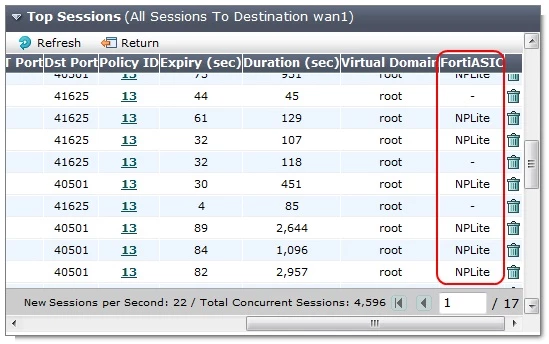

    remove software switch, disable all UTM features and try again... in fact, software switch can impact the I/O performance.. because these packets from software switch interface can NOT be handled by hardware FortiASIC(fast-path). if you enable the following features, the NPU acceleration will be lost: 1. UTM features 2. software switch 3. QoS features

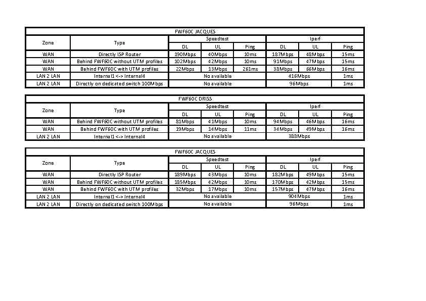

    April 25, 2013
    Hi Storaid, Good job soldier ! I did a factory reset, I just configured WAN1 interface, one Policy. Below 3 tables : - first : results before factory reset with my FWF60C ; - second : results with an other FWF60C and the same configuration as above ; - third : result with my last configuration without software switches : NB : the UTM speedtest is low because AV is enabled. When you read FWF60C datasheet, you notice the AV throughput is 20Mbps in proxy-based (versus 40Mbps in flow based). So, this result is not an issue, it' s " by design" . If I disable AV feature, the speedtest is better (about 135 - 155Mbps). In this case, this is the IPS throughput that limits my bandwidth. Thanks a lot for everybody Heodrene
