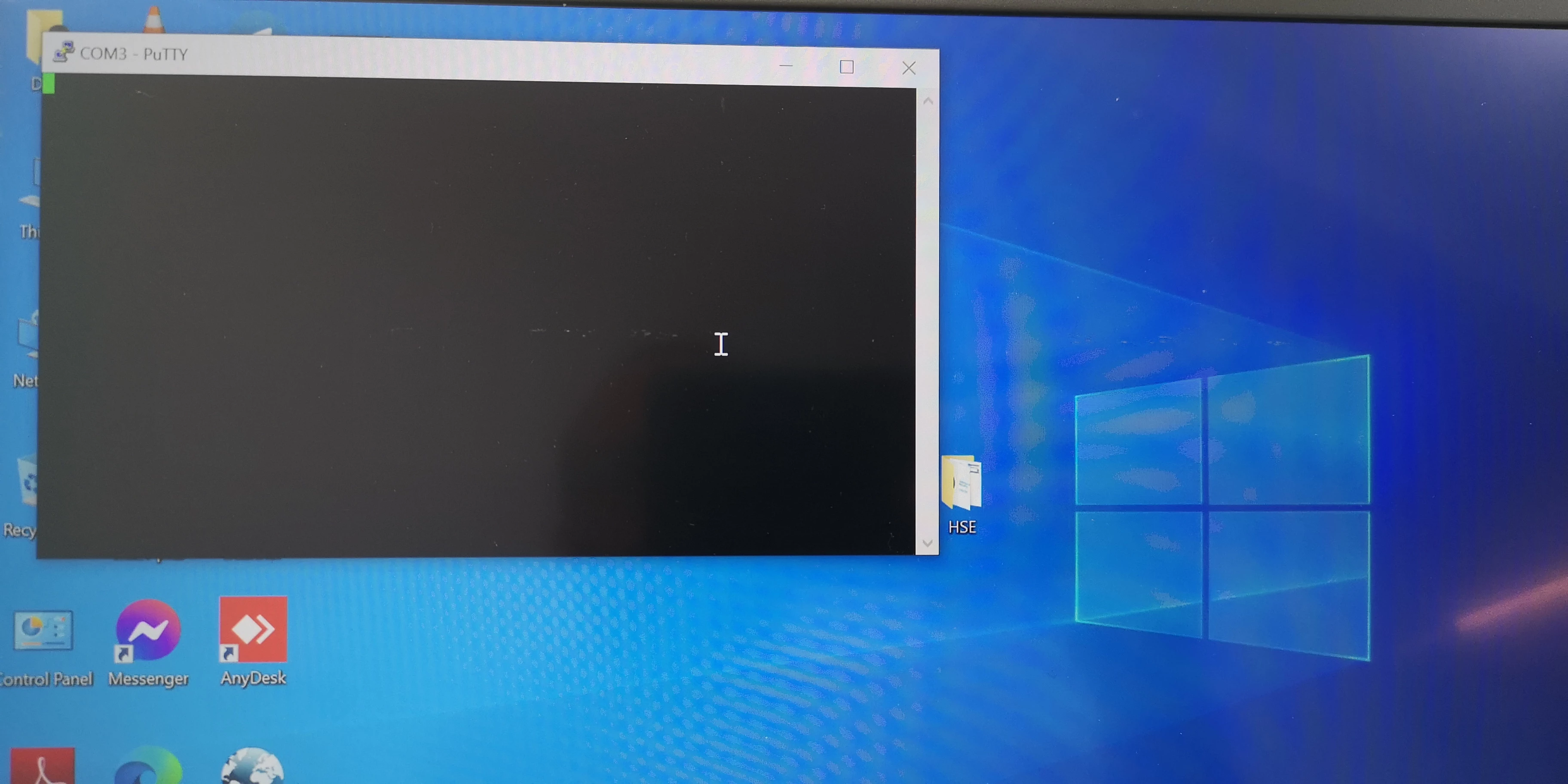

Thanks @fricci_FTNT  for the reply,
Only the 3 green small vertical next to Fatigate Logo and the Power Bottons are continuously nonstop flashing
attachedIMG_20240711_092449.jpg the Putty screen shot of what i got.
Regards
fricci_FTNT
July 11, 2024
Hi @Ghadamsi82 ,
Thank you for checking it. We should see at least some message appearing on the console, at this point the problem should be the power supply as suggested by FortiMax_it.
Best regards,
