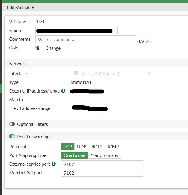

Set up VIP with external IP of WAN interface and internal IP of printer:

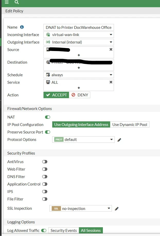

Created firewall policy with the source being the public IP of the cloud service, destination the VIP

Toshi_Esumi
March 4, 2025
The source of the IP is the real source of the incoming packet, which is generally "any" unless you limit access from one particular location. Not the FGT's interface IP. You need to know the IP the packets are coming from if you want to limit the access over the internet. That's why the FGT can't find the matching policy and giving you "denied by forward policy check (policy 0)".
Also NAT(SNAT) of the policy is optional. If you enables NAT, the device the packets are destined to can't see the real source IP. But in case of a printer, it wouldn't be a problem and it should work either with or without NAT.
Toshi

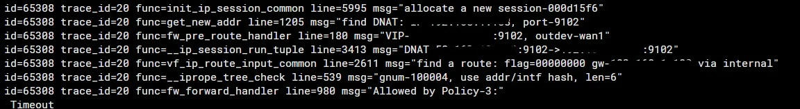

I have got it passing the policy now but printing still not working
Toshi_Esumi
March 4, 2025
Would it work if you forward everything, not port-forwarding?
