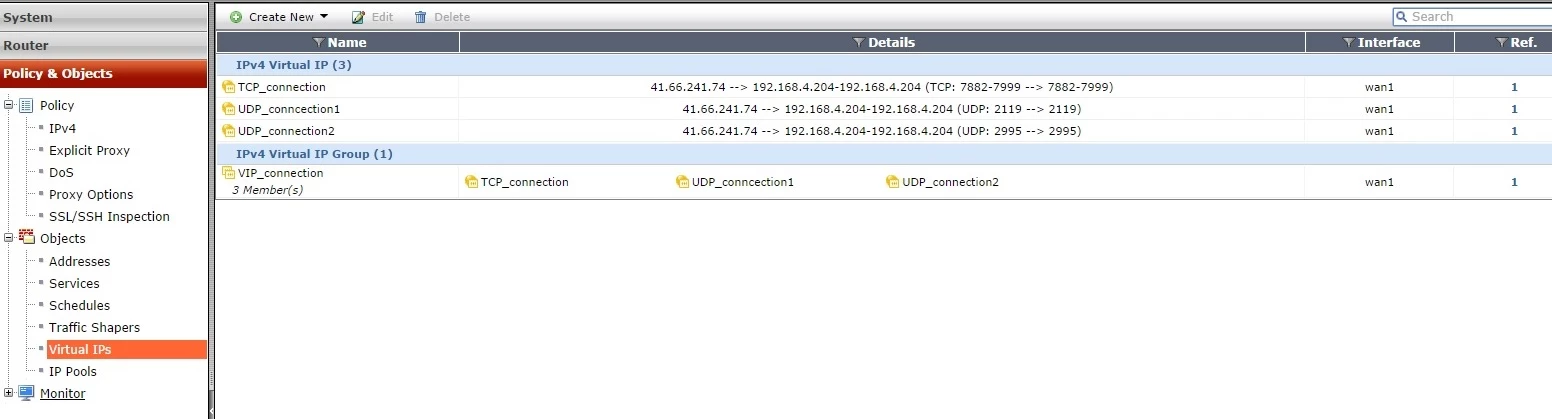

Hi , First of all I just wanted to say " Thank you" for all the nice videos that you' ve shared it helps a lot on my part. I' ve seen on the video on how to do port forwarding on Fortigate 100D which in coincidence the same unit on mine. I' ve followed all the steps on the video but still the port on 7882-7999 is closed. At first I used to mapped my CCTV server, turn off the windows firewall and Avast anti-virus. Second, I tried to configure my Ip camera to port 7882 but still no lack. On my Ip camera I can connect and I can view it on web browser. I tried as well to check on fortigate CLI to key in these command " diagnose sniffer packet any ' port 7882' but nothing happens otherwise If I' m going to do a telnet that' s the time I can see an activity on the fortigate CLI screen but on the otherhand, the result of my telnet still the same. Any help would be appreciated a lot. Thank you.

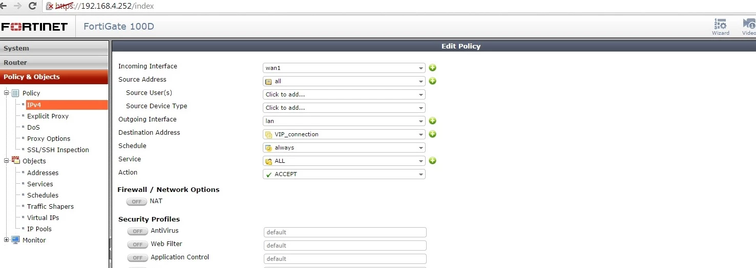

    Hi Emnoc, Please find

    Here' s my VIp' s

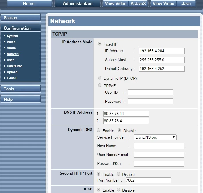

    Here is my Ip cam configuration.

    Yes. I tried the commands that you' ve advise on me but still.. on the Ip cam there is no other port assign on that, only the 7882 which i configured. by the way my Ip camera brand and model is trendnet tv-ip501p.

    I was wondering ... why the udp ports (?) - but I eventually found it. OK, following items that you can check: - on a local PC you can access the camera via port 7882 (http://192.168.4.204:7882) - the defined gateway 192.168.4.252 is also used by other PCs (so ... not the fortigate mgmt address only) - the ip address of the camera 192.168.4.204 is not within the DHCP range of the fortigate interface so that another PC may have received it as well - the udp port used in the linked example should not be needed (?) - try disabling UPNP on the trendnet camera, other users appear to have issues with it' s functionality - normally a VIP from the external address to the single port 7882 should do - alternatively, try creating a VIP using the camera default port 80 Edit:typo

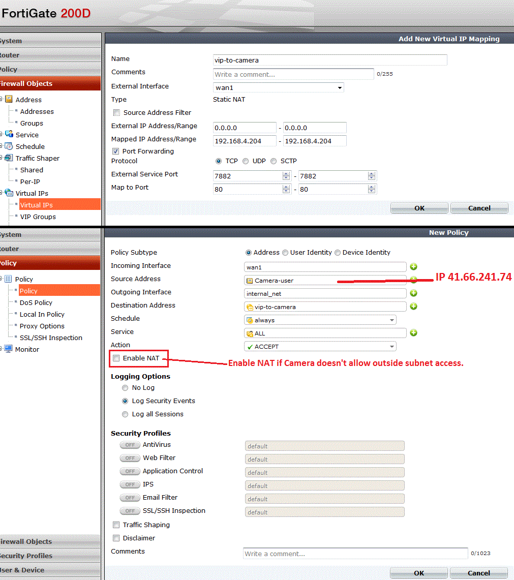

    The TV-IP501P Internet Camera User Manual doesn' t give much info on what ports is used -- it' s implied that port 80 is the default port with an optional secondary HTTP port. So setting up a port forward should be straight forward -- however, I would set it up a bit differently, along the lines of the following....
