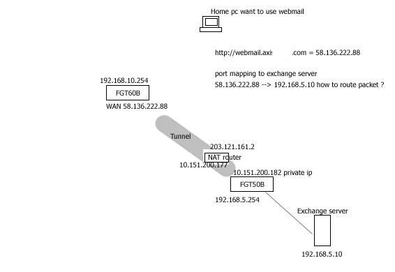

two office location , link together with vpn tunnel successfully first office have static public ip on fortigate 60B WAN interface. second office is rented office which using internet from lanlord network that we have no control of. fortigate 50B is behind lanlord NAT router second office have private ip on fortigate 50B WAN interface. two office successfully link together with IPsec vpn tunnel. fortigate 60B config as " fortigate dialup vpn server" fortigate 50B config as " fortigate dialup vpn client" it is site-to-site vpn tunnel there is e-mail server in second office, ip:192.168.5.10 connect to lan interface of fortigate 50B. i want mobile user when they travel, their can use webmail of server in second office. so I have to forward port 80 on wan interface of fgt60B to server in second office through vpn tunnel. if server is in first office it will be very easy, but this case server is in second office which can only access through vpn tunnel. subnet of fgt60B is 192.168.10.x / 24 subnet of fgt50B is 192.168.5.x / 24 how to port forwarding through vpn tunnel ?

    I have config VIP on WAN interface of FGT60B 58.136.222.88 port 80 ---> 192.168.5.10 port 80 and set firewall policy to allow traffic from WAN to VPN interface (route-based vpn) but packet still not reach 192.168.5.10. somehow packet not go from WAN interface to VPN interface. any idea ?

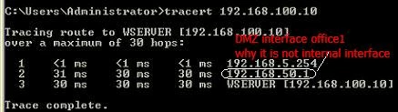

    March 13, 2011
    this is normal tracert from office1 to office2 (on computer ip 192.168.100.10) it is path 192.168.100.1---> 192.168.5.254 ---> 192.168.5.10 so if you tracert it back from office2 to office1 (on computer ip 192.168.5.10) you would expected 192.168.5.254 ---> 192.168.100.1 ---> 192.168.100.10 it go back and forward in same route path 192.168.100.10 ---> 192.168.100.1 ---> 192.168.5.254 ---> 192.168.5.10 192.168.100.10 <--- 192.168.100.1 <--- 192.168.5.254 <--- 192.168.5.10 but if DMZ interface ip does exist, fortiOS will use DMZ ip instead of internal interface ip. (in this case, DMZ ip is 192.168.50.1) this broke my routing path as in picture. How to override this behavior ? the picture is tracert back from office2 to office1 and it' s not what you expected.
