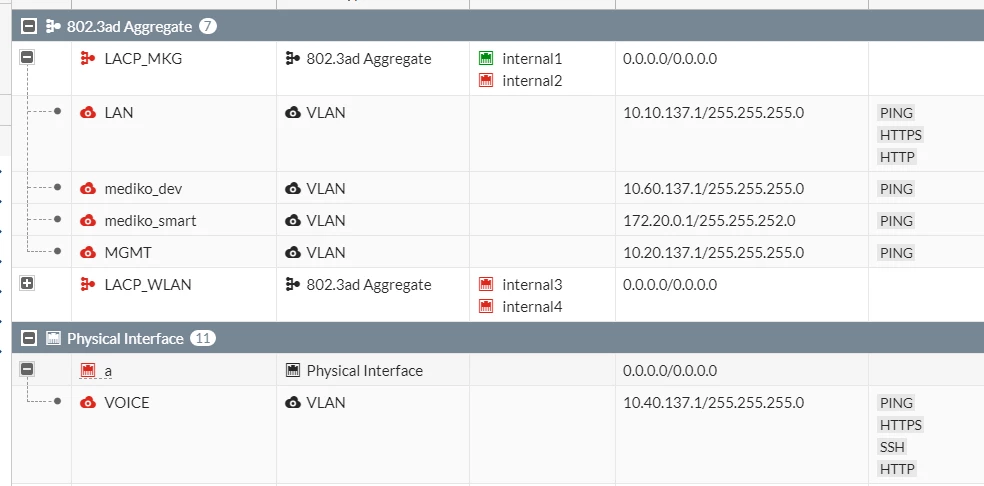

i have the following configuration
There are no wire on the LACP Ports LAN (VLAN10) and VOICE (port a) (VLAN40)

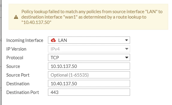

If I try the policy lookup I get the following error:
What is my problem?

Hey Kaplan,
if you run a CLI lookup on the route, it might be helpful:
get router info routing details 10.40.137.50
The used route is shown by a *.
Example:
Routing table for VRF=0
Routing entry for 10.40.0.0/16
Known via "static", distance 10, metric 0, best
 * 192.168.40.8, via wan1
It seems to have a route for that IP, better than the connected port. Or the policys dst-address object does not include the network.

I do not think, thats a routing problem.
The LACP will not go up. If a VLAN Interface do not go up, so you can not use Policy Lookup whith this interface.

You would expect that for a port without link up, the corresponding route would be removed, wouldn't you? So, this is not a routing problem. And besides, there is NO route better than a connected one, except for corner cases.

Is it possible to make the link up of ports without wire, so I can check the policys to completely or is it possible to check the matching policy undepended of any Routes?
I have there some LACP Ports but I have a problem with my netgear switch. So the LACP Ports with their VLAN will not go up.
I tried some hours to get up the LACP ports but without success.

Just to clarify, this is not a Fortigate problem, and not a 'problem' at all. Any router would remove a route if the link status is 'down'. Or else traffic would be lost on link failure. It is not uncommon to have 2 routes to a target, one being 'standby' or 'backup', and configured such that the other 'main' route is preferred. Until the link to it's next hop is lost, it's route is removed and the 'backup' route is activated and used. So, this behavior is completely correct.
I do not know of any workaround to mimick a link status.

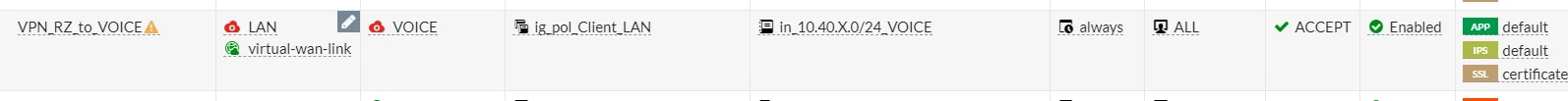

IMHO you should not complicate this - you can look up which policy is matched, without any (convenience) tool. Policy matching is as follows:
1- source interface and destination interface must match
2- source address and destination address must match
3- service must match
4- policy status must be 'enabled', schedule must be valid
so, for regular policies, the first 5 values must match. Policies are checked from top down. A FGT has 2 views on the policy table: one which is sorted by source+dest interface pairs ('segmented view'), and one in which all policies are listed top-down. You can switch between these clicking into the upper right corner.
At least in the 'complete' view, you can follow the policies and see which one matches FIRST - after a match is found, the search is terminated.
If no policy matches, the traffic is dropped silently.
