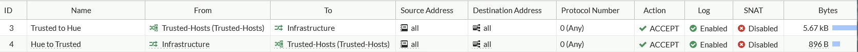

    You need to setup a multicast policy to allow the SSDP to traverse vlans.  You will also need a firewall policy to allow the clients to talk to the hue bridge as well.
    The multicast policy is hidden by default.  Go to System > Feature Viability > enable Multicast Policy.  Then you can create the policy:
