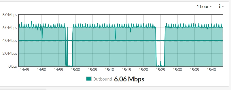

Hi,
I'm evaluating FortiGate firewalls for use in our network and for testing I got FG101F (with v6.4.3) to play around at home and get a feel for FortiOS etc. Most of the stuff i tried is working fine but i have a hard time configuring traffic shaping on WAN interface. My primary goal is to prevent congestion that for example egress UDP traffic can cause by limiting all egress traffic on WAN interface to a specific throughput and giving some applications priority over the others. My understanding was that i need to:
[ol]
  • Configure Traffic Shaping Profile with different classes and to define which class has what percentage of total bandwidth.
  • Configure Traffic Shaping Policies to assign appropriate Shaping Class ID defined previously to traffic
  • Configure Outbound shaping profile on the WAN interface as well as outbound bandwidth (4mbps in my example)[/ol]
    Unfortunately, that doesn't seem to work as there is no limiting of egress traffic. Actual upload bandwidth is 6mbps, i set the bandwidth to 4mbps.
    Looking at the session that is generating the traffic (SCP to remote server):
    fw-1 # diagnose sys session list session info: proto=6 proto_state=11 duration=1761 expire=3590 timeout=3600 flags=00000000 socktype=0 sockport=0 av_idx=0 use=4 origin-shaper= reply-shaper= per_ip_shaper= class_id=3 shaping_policy_id=5 ha_id=0 policy_dir=0 tunnel=/ vlan_cos=0/255 state=log may_dirty npu f00 app_valid statistic(bytes/packets/allow_err): org=1180266409/914030/1 reply=21615569/421425/1 tuples=3 tx speed(Bps/kbps): 806177/6449 rx speed(Bps/kbps): 14746/117 orgin->sink: org pre->post, reply pre->post dev=47->7/7->47 gwy=Y.Y.Y.1/10.0.10.10 hook=post dir=org act=snat 10.0.10.10:56912->X.X.X.X:22(Y.Y.Y.Y:56912) hook=pre dir=reply act=dnat X.X.X.X:22->Y.Y.Y.Y:56912(10.0.10.10:56912) hook=post dir=reply act=noop X.X.X.X:22->10.0.10.10:56912(0.0.0.0:0) pos/(before,after) 0/(0,0), 0/(0,0) src_mac=a8:a1:59:08:03:c4 misc=0 policy_id=2 auth_info=0 chk_client_info=0 vd=0 serial=002c9ebd tos=ff/ff app_list=2000 app=16060 url_cat=0 sdwan_mbr_seq=0 sdwan_service_id=0 rpdb_link_id=00000000 rpdb_svc_id=0 ngfwid=n/a npu_state=0x003c08 npu info: flag=0x81/0x81, offload=8/8, ips_offload=0/0, epid=66/70, ipid=70/66, vlan=0x000a/0x0000 vlifid=70/66, vtag_in=0x000a/0x0000 in_npu=1/1, out_npu=1/1, fwd_en=0/0, qid=7/4 total session 1
    Traffic seems to have the right class_id and was classified by correct shaping policy:
    fw-1 # show firewall shaping-policy 5 config firewall shaping-policy     edit 5         set name "network-services"         set service "ALL"         set app-category 15         set dstintf "wan1"         set class-id 3         set srcaddr "all"         set dstaddr "all"     next end
    I also don't have any traffic shaping policies that actually shape traffic (they just assign the class id) if that matters. This is my outbound shaping profile (note that class-id 3 has a maximum-bandwidth-percentage set to 20%):
    fw-1 # show firewall shaping-profile config firewall shaping-profile     edit "outbound-profile"         set default-class-id 2         config shaping-entries             edit 1                 set class-id 2                 set priority medium                 set guaranteed-bandwidth-percentage 10                 set maximum-bandwidth-percentage 90             next             edit 2                 set class-id 3                 set priority critical                 set guaranteed-bandwidth-percentage 10                 set maximum-bandwidth-percentage 20             next             edit 3                 set class-id 4                 set priority low                 set maximum-bandwidth-percentage 90             next             edit 4                 set class-id 5                 set guaranteed-bandwidth-percentage 30                 set maximum-bandwidth-percentage 90             next             edit 5                 set class-id 6                 set priority top                 set guaranteed-bandwidth-percentage 20                 set maximum-bandwidth-percentage 40             next         end     next end
    And finally this is the configuration of the WAN1 interface:
    fw-1 # show system interface wan1 config system interface     edit "wan1"         set vdom "root"         set mode dhcp         set allowaccess ping         set type physical         set inbandwidth 60000         set outbandwidth 4000         set egress-shaping-profile "outbound-profile"         set monitor-bandwidth enable         set role wan         set snmp-index 3         set macaddr 00:1d:70:1a:0c:b0     next end
    It seems that the traffic is classified correctly but is not shaped on the WAN interface (like there's not enough traffic to activate the shaper).
    fw-1 # diagnose netlink interface list wan1 if=wan1 family=00 type=1 index=7 mtu=1500 link=0 master=0 ref=212 state=start present fw_flags=0 flags=up broadcast run multicast Qdisc=mq hw_addr=00:1d:70:1a:0c:b0 broadcast_addr=ff:ff:ff:ff:ff:ff inbandwidth=60000(kbps)         total_bytes=0   drop_bytes=0 egress traffic control:         bandwidth=4000(kbps) lock_hit=0 default_class=2 n_active_class=5         class-id=4      allocated-bandwidth=0(kbps)     guaranteed-bandwidth=0(kbps)                         max-bandwidth=3600(kbps)        current-bandwidth=0(kbps)                         priority=low    forwarded_bytes=0                         dropped_packets=0       dropped_bytes=0         class-id=2      allocated-bandwidth=400(kbps)   guaranteed-bandwidth=400(kbps)                         max-bandwidth=3600(kbps)        current-bandwidth=32(kbps)                         priority=medium         forwarded_bytes=6254K                         dropped_packets=0       dropped_bytes=0         class-id=5      allocated-bandwidth=1200(kbps)  guaranteed-bandwidth=1200(kbps)                         max-bandwidth=3600(kbps)        current-bandwidth=4(kbps)                         priority=high   forwarded_bytes=271K                         dropped_packets=0       dropped_bytes=0         class-id=3      allocated-bandwidth=800(kbps)   guaranteed-bandwidth=400(kbps)                         max-bandwidth=800(kbps)         current-bandwidth=0(kbps)                         priority=critical       forwarded_bytes=50K                         dropped_packets=0       dropped_bytes=0         class-id=6      allocated-bandwidth=1600(kbps)  guaranteed-bandwidth=800(kbps)                         max-bandwidth=1600(kbps)        current-bandwidth=0(kbps)                         priority=top    forwarded_bytes=0                         dropped_packets=0       dropped_bytes=0 stat: rxp=166142958 txp=99311737 rxb=197027690325 txb=17448900949 rxe=0 txe=0 rxd=0 txd=0 mc=0 collision=0 re: rxl=0 rxo=0 rxc=0 rxf=0 rxfi=0 rxm=0 te: txa=0 txc=0 txfi=0 txh=0 txw=0 misc rxc=0 txc=0 input_type=0 state=3 arp_entry=0 refcnt=212
    This output shows 0 kbps for class-id 3 even though there's 6mbps. I would expect that setting the outbound bandwidth to 4mbps would limit egress traffic regardless of classification.
    I hope i showed enough relevant config snippents, and I'll provide additional info if you need it. As this is my first week with Fortigate there could be that I'm missing something obvious so I would appriciate your help.
    Thanks,
    Pavle

      I'm having almost the exact same issue in my environment.  Set limit of 300 Mbps on the interface, setup shaper profile with class-id's, assign policies that assign the class-id's, apply policy then bam! - nothing is throttled, hitting speeds of 500+ Mbps, and the interface shows little to no activity via CLI.
      Right now I have a policy that directly applies a shaper instead of a class-id to hold things together for now.
      FG60E running FortiOS 6.2.5.
