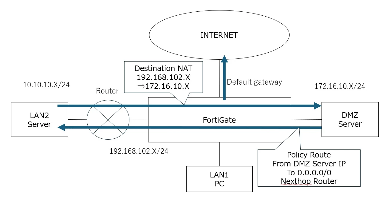

Here is a simple topology diagram.
This is a test configuration, so it differs slightly from the production environment, but I believe it is sufficient for verifying the behavior of the policy-based route.
My personal hypothesis is that the issue might be caused by using Destination NAT in conjunction with the policy-based route, or by setting the destination of the policy-based route to the default route when one already exists.
Any additional advice would be greatly appreciated.

Toshi_Esumi
September 11, 2025
So, all traffic initiated by the DMZ Server needs to go to LAN2 Server regardless the destination IP of those outgoing packets instead of going out through the "Default Gateway" to the Internet?
Then you need to have another default route going toward the LAN2 Server. Do you have it? Without a proper route matching the destination IPs in the routing-table, no policy routes would work. Since you want all other internet-bound traffic, like from LAN1 PC, to go out to the internet directly, you need to make the default route toward the LAN2 Server less-preferable. If static, you can do that with priority.

Toshi_Esumi
September 12, 2025
I didn't say "the policy route and the routing destination need to match."
I said, when you steer a particular traffic, let's say to 8.8.8.8/32, toward an interface, there needs to be a matching route, which could be just 8.8.8.8/32, or 8.8.0.0/16, or 0/0. Otherwise the FGT can't route the packet to the interface.
In your case, you implicitly said "all traffic from the DMZ server". So only option is 0/0 route.
Basically FGT's policy route doesn't inject any routes itself nor override (unlike some other vendors routers/FWs). Proper routes always need to exist regardless using policy-route, SD-WAN steering or whatever.
Toshi
Toshi_Esumi
September 12, 2025
It's hard to find this fact in FTNT's documenation. But this KB states it in one sentence even with smaller fonts:
https://community.fortinet.com/t5/FortiGate/Technical-Tip-Configuring-the-Firewall-Policy-Routes/ta-p/189996
"Requirement: The routing table must have an active route to the gateway or the destination."
That's why you can't use admin distance with the second default route. It wouldn't be "active" in the routing table.
