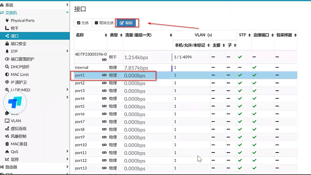

微信图片_20241224174319.png微信图片_20241224174336.pngHello, why does the browser display a blank page when opening the switch web page? I tried switching to Google Chrome and Edge Browser, but it still works the same way

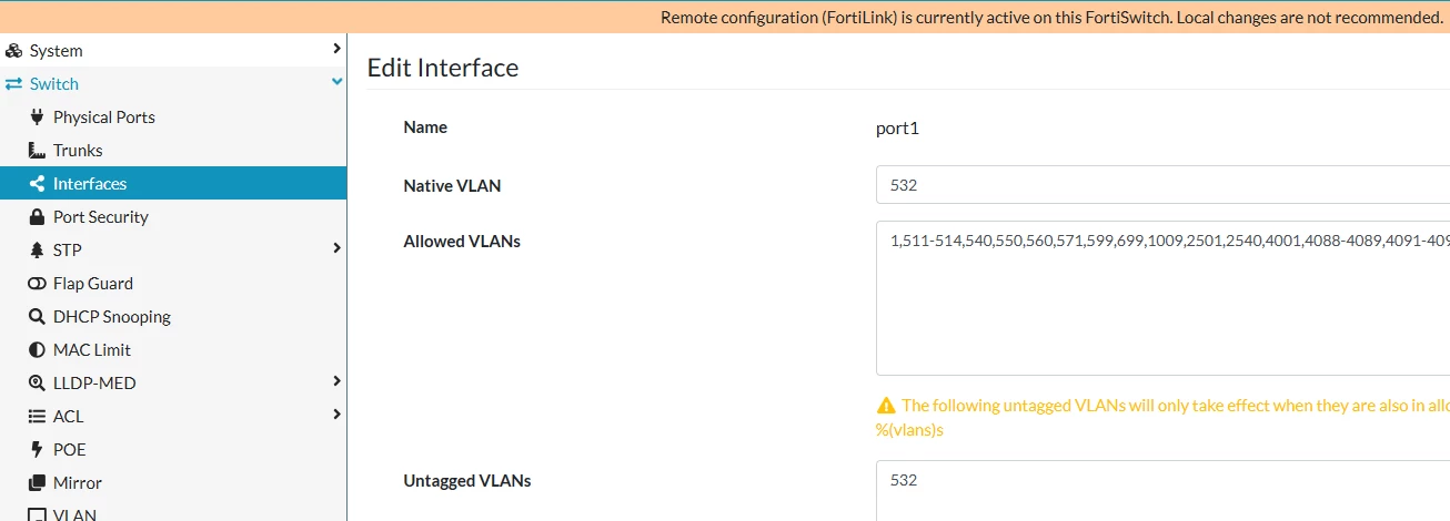

It looks like you get this blank page when you try to edit a switch interface in a FSW managed by the FGT (FortiLink mode). Is there a reason why you are trying to do local port changes in a managed switch? It's recommended to do the port changes through the Switch controller page in FGT.
Anyway the page should still be opened and you should get a banner to discourage local changes. Which firmware version is it currently running?
