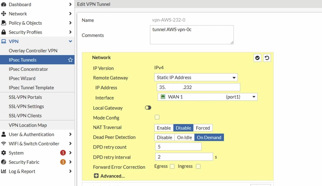

For a client, I am trying to setup a vpn site-to-site from a local Fortigate 200F, firmware 7.2.3, to the AWS site-to-site connectors.
I succeded to make it so I could ping from AWS to a local machine, but ping from a local machine to a AWS machine would not work.
How I did it and config
I went in the docs of AWS and Fortinet, followed them, then downloaded the IKDv2 configuration file, followed the instructions, and it was pretty smooth for those parts.*

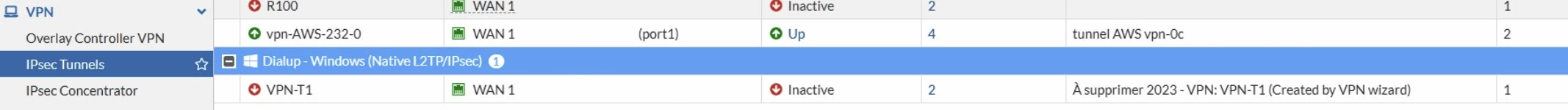

Fortigate Network IPSEC tunnels section here:

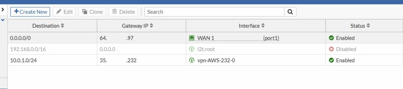

Fortigate routes here:

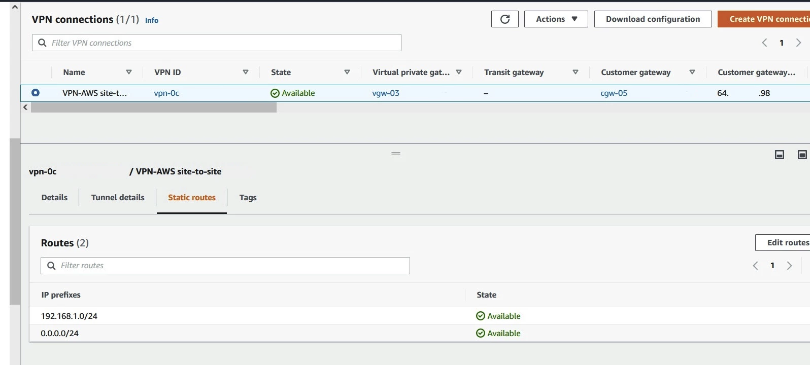

So the route on AWS side are working and I suspect that the AWS side is not the cause here:

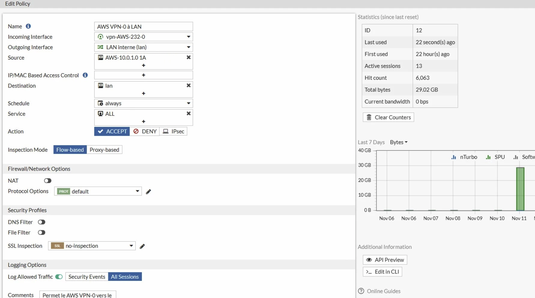

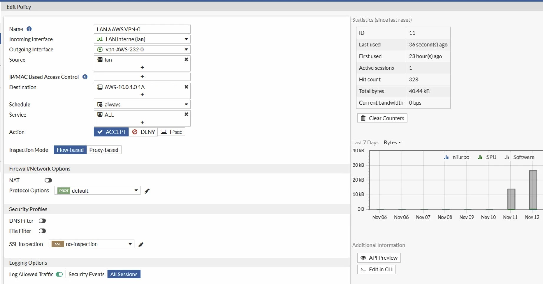

My Firewall policies are there:
And If I DENY my AWS VPN to the local LAN, the pings from AWS to local LAN stops, so this is proof that that direction goes by the Firewall.
If I reverse that by putting "AWSVPN to LAN" to ACCEPT, and "LAN to ASWS VPN" to DENY, there is no difference to my problem obliviously.
