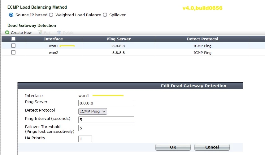

Hello ,
i have  old device 800c with  Firmware Version v4.0,build0656,130211 (MR3 Patch 12)
I want to ask
1.  how to set Gateway Failure (Recovery) Actions for Link Health Monitor  ( 2 isp , wan 1  & wan 2 )
2.  is it possible upgrade firmware  to  v5 or v6 ?  please suggest
regard

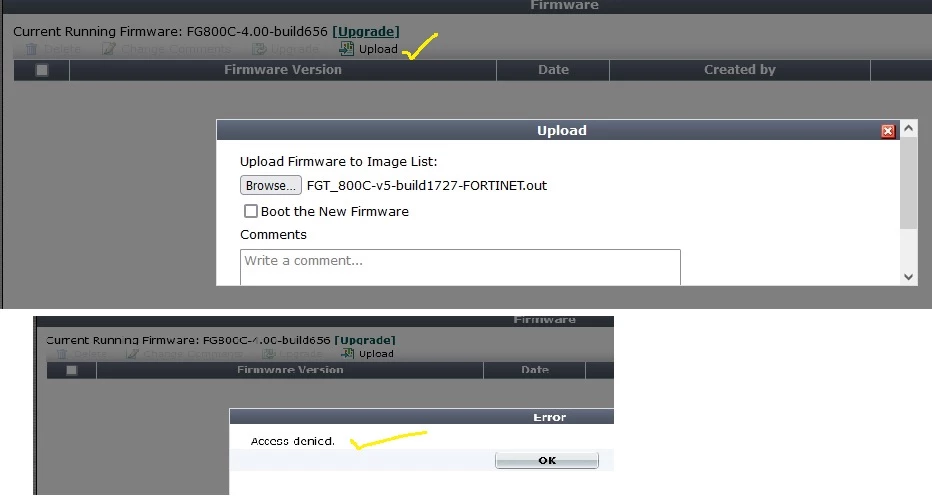

Hi Eko
Regarding your 2nd question,
The latest possible FortiOS on FG 800C is 5.6.14.
But you need to have a valid support contract, which I guess is not the case.
Nevertheless I'd suggest to check with your local Fortinet account manager or local Fortinet partner if they can help in such case.

Hi  AEK
yes,  for this device ,  i dont have valid contract.
so that why , i  try  my self  , manual upload  firmware file  ,  but  upload file firmware.jpg  access denied  .

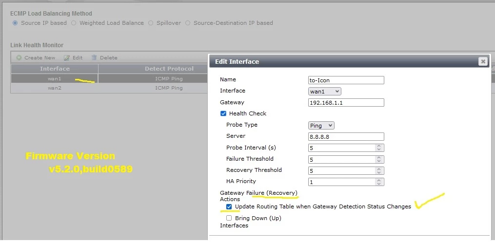

For the first question, what do you mean by action if not removing/adding default route?
Also check this tech tip if it can help.
https://community.fortinet.com/t5/FortiGate/Technical-Tip-Link-monitor/ta-p/197504

dear AEK ,
i mean  if   internet 1 , down ,  routing auto  update  routing table
like these pict.
fortios v.4fortios v.4fortios v.5fortios v.5
AEK
October 2, 2024
Hi Eko
Can you check with command line?
config system link-monitor
  edit X
    show full    (or get)
AEK
