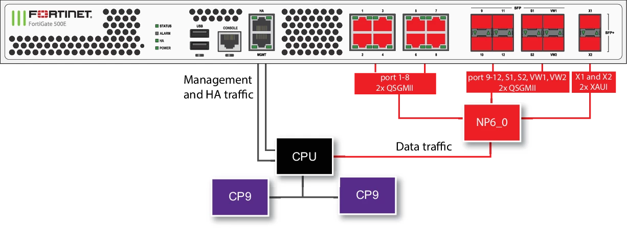

As traffic always passes the NP6 I am asking myself whether there is a kind of limitation regarding UDP traffic?
fffea411975e36902ce7f5fbfca3fbe7_FG-500E-Front
