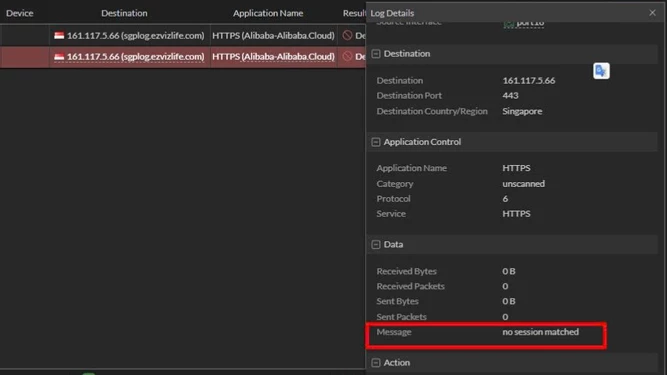

Hello everyone, hello experts.
I'm currently having an issue with activating an EZVIZ camera. The activation fails and the logs show a 'no session matched' error. I've tried several different methods, but none of them worked.
Is there any way to resolve this issue completely, and which configuration steps should I pay attention to? Does using SD-WAN affect this, and what can I do to allow it?
Thanks you so much!
id=65308 trace_id=430 func=fw_forward_dirty_handler line=401 msg="no session matched"

Thank you for the expert's response. I have looked through the articles about 'no session matched', but unfortunately, they do not apply to my situation.
- config system global:
set tcp-halfclose-timer 3600
    set tcp-halfopen-timer 120
edit 40
        set name "Sgplog.ezvizlife.com"
        set uuid ....
        set srcintf "LAN-Local"
        set dstintf "virtual-wan-link"
        set srcaddr "Texter"
        set dstaddr "all"
        set service "ALL"
        set anti-replay disable
        set logtraffic all
        set auto-asic-offload disable
        set nat enable
        set session-ttl 3600
        set tcp-mss-sender 1200
        set tcp-mss-receiver 1200
        set comments "Policy for camera"
