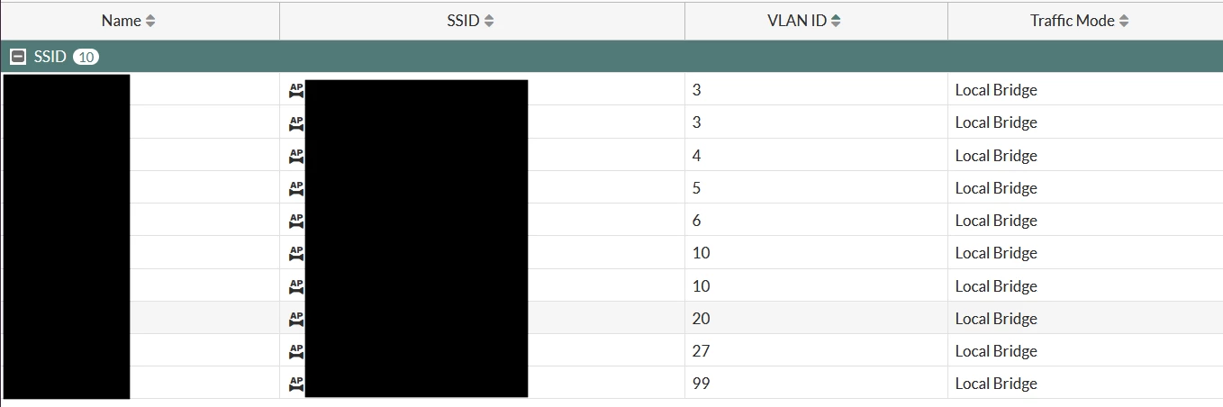

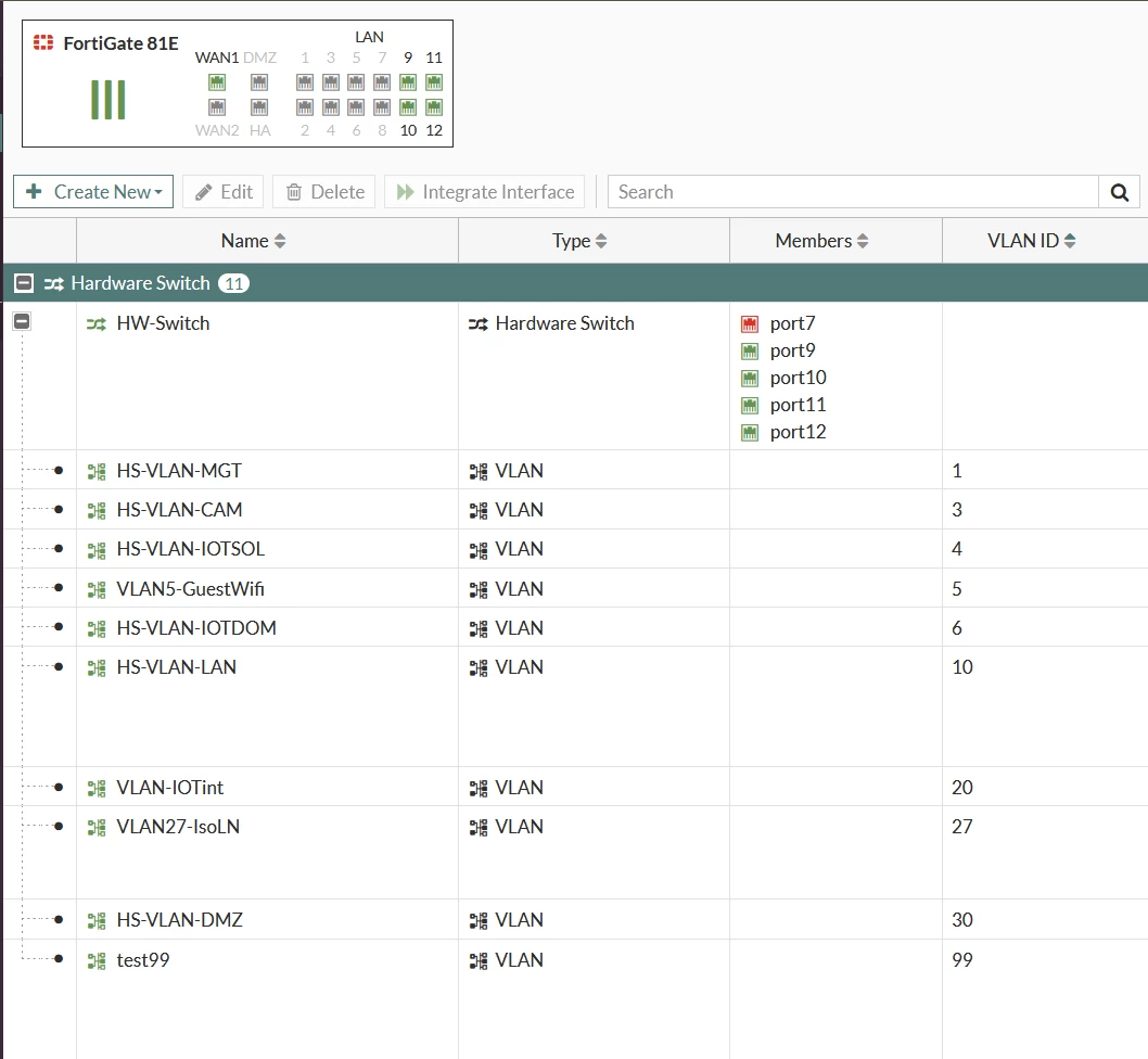

So... today it was the big migration day. All converted to 1 HW Switch with VLANs and all SSIDs bridged. Makes the config more clear and consistent. It was a big hassle to get all VLAN config in the Netgears, whoever though of that interface must have been smoking something :-).
Quickly recap the situation before.
I came from a long road in terms of versions and config. All worked well for years when I was using software switches and by that means bridged tunneled (!) ssids to a softwareswitch combined with a hardware port. A dumb switch connected to such a switch would pass all traffic including tagged and untagged traffic.
This was up until 7.0.10 very successful. When I upgrade to 7.0.11 problems started. At first it was not very clear, random white pages, slow loading, games not starting, etc. The best way to test was by starting a Roblox game. This would always fail in 7.0.11. Downgrading to 7.0.10 and it always was successful.
Because I needed to do some and the "softwareswitch combination" was not accepted by the GUI and CLI anymore, I converted all networks to VLANs and created a new hardware switch (HW-Switch).
That's all in this novel topic.
Instantly when downgrading to 7.0.10 all problems were gone!
But now I have created the new setup I still have the same problems. Starting roblox on the SSID bridged to the LAN VLAN (10) is not able to start, Starting Roblox on the test99 SSID VLAN (99) is starts. Always, no exception.
Below the relevant configs. and attached the gui.
Config:
edit "HW-Switch"         set vdom "root"         set ip 192.168.253.1 255.255.255.0         set allowaccess ping https ssh http         set type hard-switch         set lldp-reception enable         set lldp-transmission enable         set role lan         set snmp-index 48     next edit "test99ssid"         set vdom "root"         set type vap-switch         set alias "b"         set role lan         set snmp-index 45     next     edit "HS-VLAN-LAN"         set vdom "root"         set ip 192.168.1.254 255.255.255.0         set allowaccess ping https ssh http         set device-identification enable         set monitor-bandwidth enable         set role lan         set snmp-index 49         set interface "HW-Switch"         set vlanid 10     next     edit "test99"         set vdom "root"         set ip 192.168.99.1 255.255.255.0         set allowaccess ping https ssh http         set role lan         set snmp-index 14         set interface "HW-Switch"         set vlanid 99     next   config system virtual-switch     edit "HW-Switch"         set physical-switch "sw0"         config port             edit "port7"             next             edit "port9"             next             edit "port10"             next             edit "port11"             next             edit "port12"             next         end     next end

today I had a busy day. Migrated all to 1 HW-Switch. All is "functional" now. But you don't believe it. The problem persists. Roblox does work in vlan99 (ssid test99) but not in vlan10... (LAN VLAN)
Quick recap:
I did not have any problems until 7.0.10. It started in 7.0.11. When downgrading to 7.0.10 problems were gone. I had to upgrade to 7.0.11 due to the usage of sslvpn.
I did us software switches combining hardware ports and tunneled ssids. Now all segments are VLANs on 1 hardware switch.
Some info from now:
The config:
    edit "WiFi5G"         set vdom "root"         set type vap-switch         set alias "b"         set role lan         set snmp-index 19     next
On the top of the policies there are 2 identical policies allowing vlan 99 and vlan 10 full to the internet...
Again: This problem was not there in 7.0.10 (!) Although now the situation is a little different.

See configs and layout above. test99 is a vlan (99) normal sidd is a vlan (10). Same policies (on top) and on same FortiAPs, both ssids bridged (one to vlan 99, one to vlan 10)
Both ssids are thus on the same AP, on the same radio...
