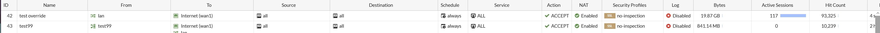

  • Created a new test policy, top placed any/any allow, no filtering, NAT to internet.

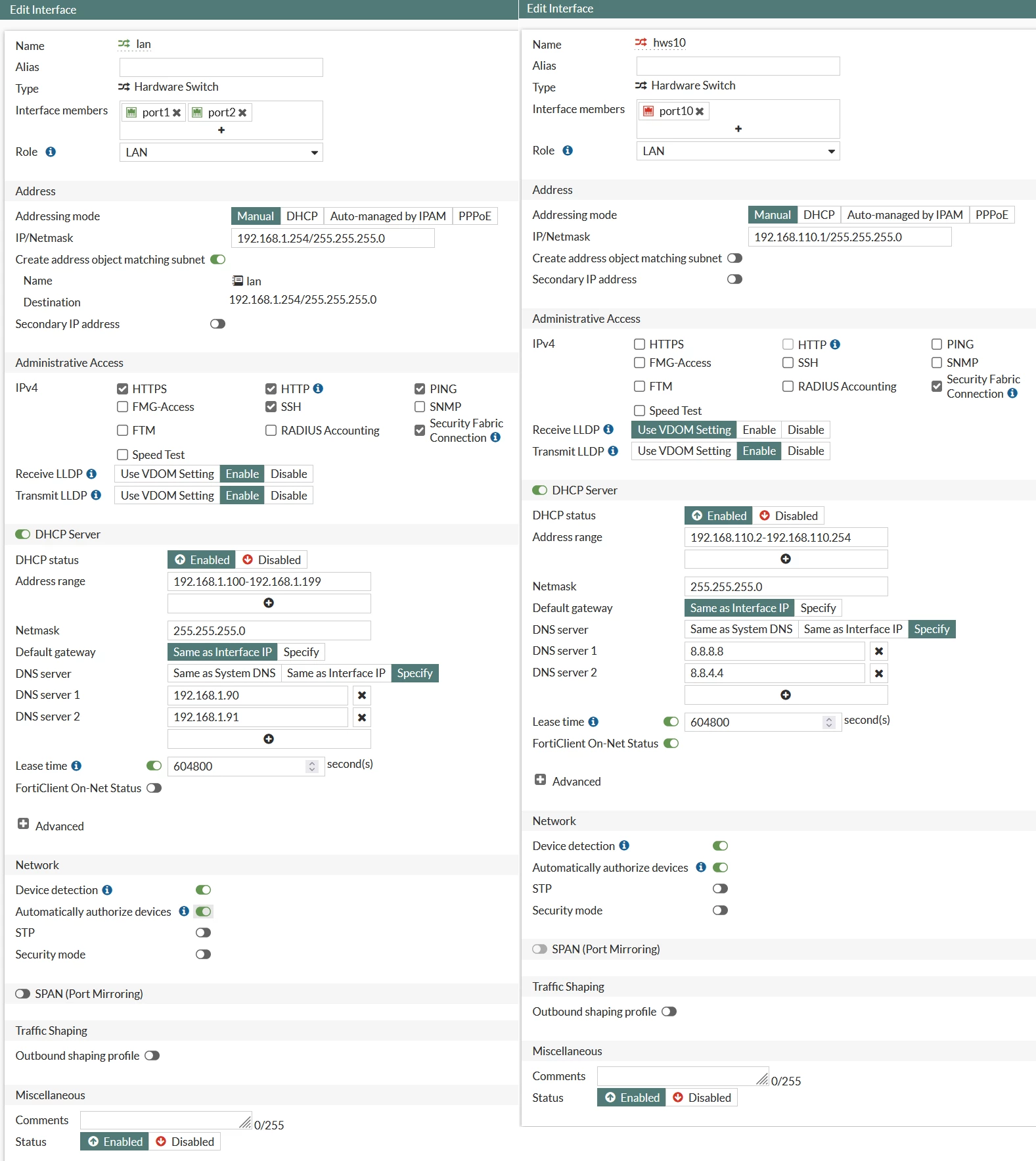

I created a new (empty) hardwareswitch (hsw10) with port 10.
Connected a fortiap to port 10.
bridged an ssid to it.
added a new subnet on hsw10.
Added policy to internet.
Roblox works...

Hi Graham, thanks for helping out. I have no active subscription on this device so I would not be able to contact support right?
Attached screenshot:lan+hws.png
Some remarks about the screenshot:
same DNS server is no difference (now used google), tried some with LLDP on/off, currently the port 10 is not connected to the AP anymore

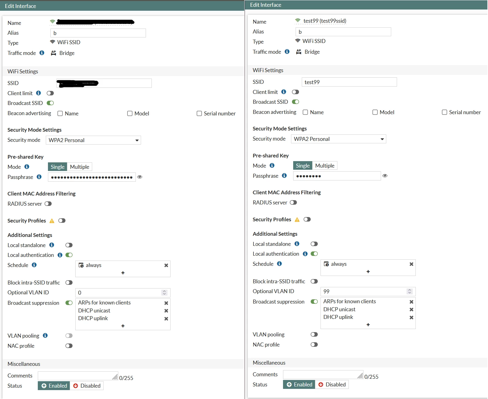

Both ssids are on the same ap... of which the left is bridged directly on the lan switch (with an ip address and dhcp scope). the test99 is bridge into 99.
I had this running for around 3 years or so, on many FortiOS versions and just recently these vague problems started.
In the mean time, as I discovered a "newly" created hardwareswitch with an ssid bridge to that (with a new vlan) does work, I an now in the phase of migrating everything to a new harwareswitch and vlans.
It is a hassle due to the "refs" connected to everything and CLI is a too big risk to change...
so I would really hope to find out why this suddenly startedand is so clearly releated to my "old" hardwareswitch. --> it is not only wifi traffic having problems, also fixed (wired) devices connected directly to this hardwarswitch have vague conneciton problems.
Luckily Roblox is the most "picky" one with which I can easily prove something is wrong when conected to lan. And again, all is right on test99...
Attached but ssid configs:ssid.png

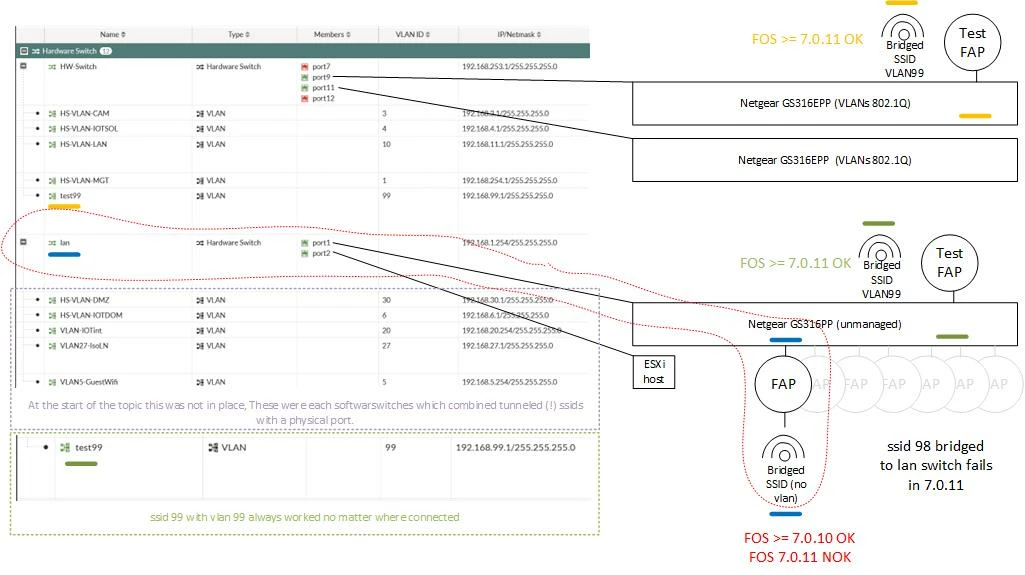

<Does the FAP work in the managed switch with all SSID and bridging scenarios? Is it only a problem on the unmanaged switch?>
FAPs worked for 5 years via unmanaged switch, with the "main SSID" bridged to vlan 0 (the hardware "lan" switch. Up until v 7.0.11 there it broke.
Another FAP connected to the managed switch also works well, but obviously via another management vlan and via trunks etc. --> not the issue now.
<When you say you are testing the SSID by bridging directly to the hw switch, how are you accomplishing that?>
So:
Don't ask too complex questions... the problem is very simple and it only is there in 7.0.11. In 7.0.10 it was gone directly. Nothing fancy here...

So long: in all versions above worked. it only stopped in 7.0.11. and when reverting to 7.0.10 it works.
Again, I am talking here about plain simple bridging ssid (vlan 0!) default to the hardwareswitch (lan).
This firewall only goes back to 6.4.5. But the config was inherited from another Fortigate (60E) and goes back working up to even 5.4 I believe so... 6.0, 6.2, 6.4 then 7.0
I understand its not too clear. Its not easy to describe this.
I Only talk about fortigate when I talk about lan switch. My lan switch is called "lan" and it's a hardware switch.
See the screenshot. By default the is no vlan (0) when you create a bridge vlan. It just puts the taffic untagged on the wire. In the new situation indeed I have vlan 1 in my managed netgear, as a native vlan and there the ap is in the native vlan 1 to be managed. There I am going to create vlan 10 as my new "lan" segment (what is now the lan switch - on the fortigate)
BTW, I really appreciate you taking the time to help me. I hope al is now clear.
Please see the screen shot for the SSIDs... there you see vlan0 for the main ssid (bridged to the lan-switch, on the fortigate), this worked for years, but stopped (not totally but partially! read the roblox - and others problems) in 7.0.11
